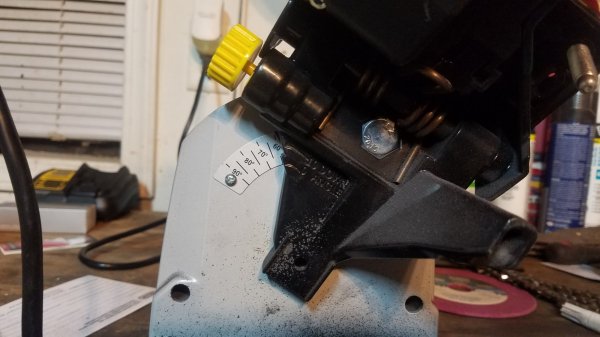

    Hope this helps fellas

    lower it down to 50 and see if that makes you happier
  3. huskihl
    huskihl
    Jan 30, 2016
    3,728
    21,489
    Yep. I'd try it over at 50. Make a perfect round on the wheel, and don't sharpen with the side of the wheel. And compare the 2 and see what you think

    That'll make more hook hopefully. Especially now that I know what the wheel needs to look like.
    Thank you both dall and huskihl

    Your cutter should look like a ( instead of a C. Hope that helps

    On semi chisel, I've had to go sharper or deeper to get any hook at all. Or lower rakers to get it to cut on its own

    Have you tried grinding one with a little tilt? I know they don't call for it but I think it helps it feed.

    I'd imagine it would help. Sharper feeds better.

    By tilt, what do you mean? This noob Is clueless.

    The 10° vise tilt you mentioned earlier

    The 10 degree down angle? Now I gotta run 4 different chains in a test?

    Good way to figure out angles is take a new chain out of the box. Throw it on the grinder and set the angles by fitment . Doing this with the grinder shut OFF of course .

    .043
    50* tilt
    35* angle
    Depth stop set more shallow to use just the curved part of wheel.
