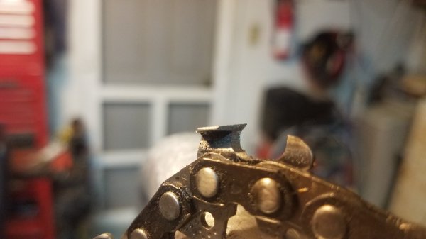

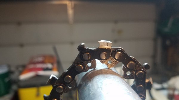

    Ground one at 55* instead of 60. It seemed to give me more "c" shape in the side of the cutter and to the touch felt sharper.
    The 60* didn't impress me in the wood to be honest, but that may have been cuz I was all one foot on a split bent over cutting cookies on ice :(
    Back outside to make some more chips with the 55*

    even the files that is recomended seems too big the cutter looks to be straight up and no hook like it could use more angle maybe 50 degrees

    It also looks like a semi chisel in the pic he posted. It's hard to make it look like semi has any hook

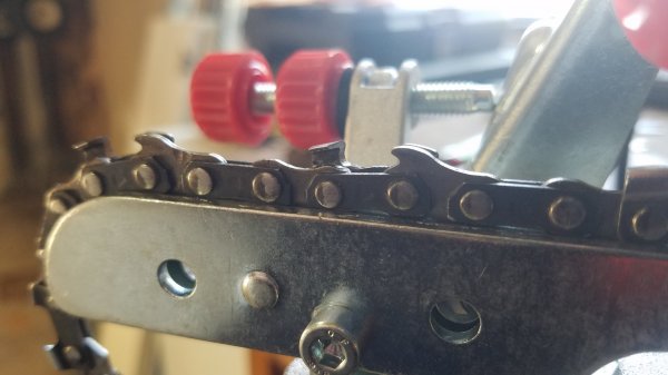

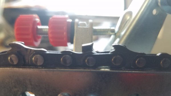

    Yea....the Pico sux donkey balls. Need one of those magnifying glasses from page 1 of this thread.
    I moved to 3/8 .050 and at 30 and 60 they are matching the stihl reference marks.

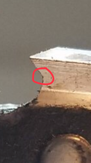

    Be careful about going to Deep. I usually stop going deeper when the point of the cutter reaches the side of the wheel. I only sharpen with the round portion of the wheel

    Too low on the side plate is what you are saying?

    Again, to each his own. But to me, the bottom of the wheel should be shaped perfectly round. And I'd stop going down into the tooth at the point where the top of the cutter reaches the side straight part of the wheel. You're driving down a little bit deeper than that

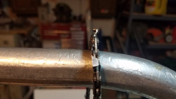

    All I know is that in the past few hours I fixed a whole lotta chains that were beyond a file. Rocks, metal, dirt, etc.
    11 chains done so far. 5 to go. Tomorrow am with coffee is raker time.
    Pile of metal lol

    This point that I circled is what he is referring to.

    I'll set the depth stop a little shallower. I figured that step half way down would drag thru the cut.
    Barcroftb and huskihl like this.
  20. huskihl
    huskihl
    Jan 30, 2016
    3,725
    21,469
    Yessir. They look like they'll cut fine.

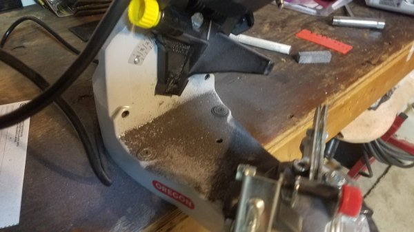

    Did you get a flat red gauge reader with your grinder? It has a wheel profiler on it.
