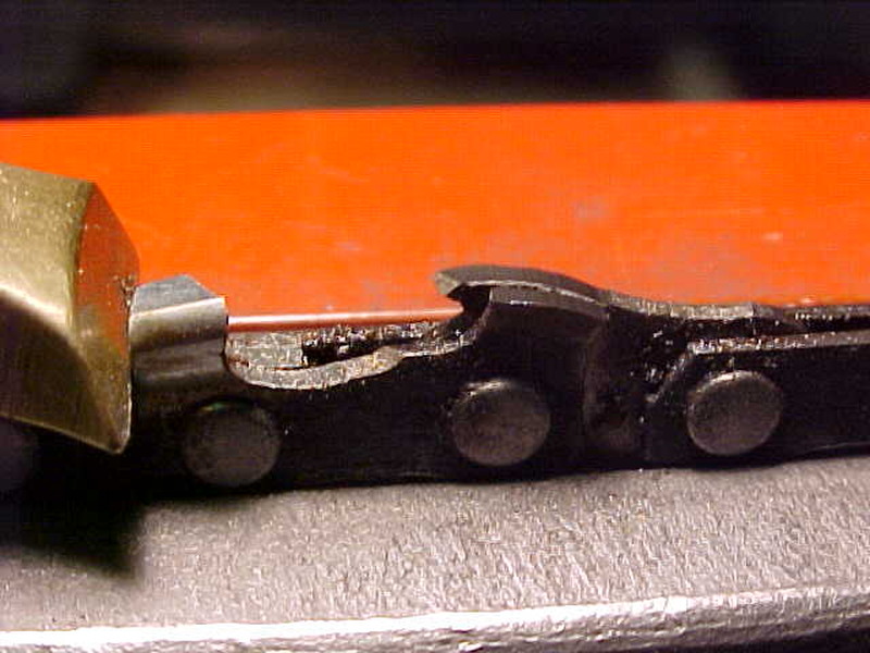

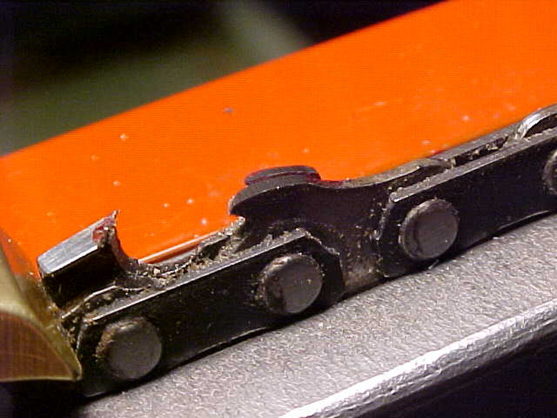

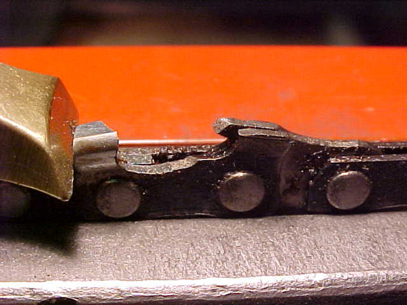

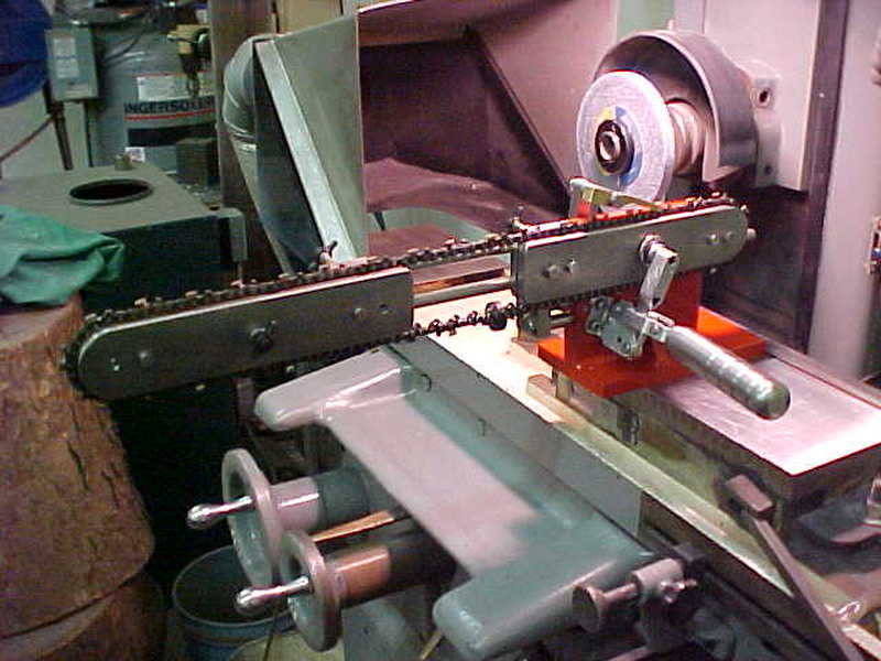

    For what it is worth, here is what I've found. I run full house chain on all my saws even on the 3 and 4 ft bars. I made up a raker grinder that grinds the factory radii and contours for Picco and RS.
    Before
    After.
    Having the contour on a smooth transistion does make the saw cut smoother in my experience. especially when plunge cutting. I've found the same when your teeth are all the same length wise with sharpening. My theory is if your cutters are all different sizes, the chain has to pull up in spots to grab the same chip size. or it'll be cutting smaller, finer chips. It would be more of a factor on a longer bar. It can be a plus as in my mind, it would basically take less HP to spin the chain as you, in theory, would be making it a sort of skip chain. Thoughts?
    I did the Raker/depth gauge fixture as an experiment and was surprised at the difference it makes. Just playing around in the shop and WAY overkill I know but it was interesting.

    Truly impressive Kevin. Us mortals grind the rakers, You grind the wheel.

    Those are full complement Kevin. I dont know that Ive even seen full house in person, would be cool though!I like that surface grinder setup too btw.
