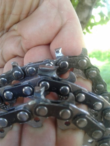

    Can you tell me the benefits or drawbacks of using the tilt?
    When I finally got to use the saw, I ran a 55* stihl with Rakers Down .030. It cut as good or better than a new chain Imo.
    Btw....that customer chain. Ho. Lee. Chit. That's baaaaaaaaaad.

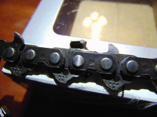

  19. mdavlee
    mdavlee
    Oct 21, 2013
    4,380
    10,479
    None of mine have hook?[​IMG]
