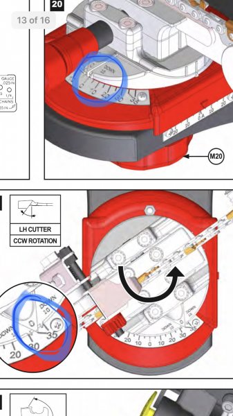

    bocefus78 let me start out by saying I am no expert and I am always learning, I am always Leary of the guy whom seems to “know it all”....I have been lucky enough to have a few guys that have had a lot of experience help me get started right, then I put my nose to the grind stone and set my goals high....when I started grinding I wanted to be able to grind a chain that cut as good or better than new, I have done that...
    Ok as far as angles on my Oregon 520 I put the head tilt at 55, I use the manufacturer recommended top plate Angle, (for Stihl usually 30, Oregon usually 25)....now when it comes to the tilt, on customers Chains I usually don’t use it....now IF you do want to use the tilt, remember this....there are little marks on the base you use to set the top plate angle...when you use the tilt, it changes the top plate angle....also when using the “tilt” the head tilt angles change too....what angles are you currently using, and if I you have a question I will try to answer it!!!!!
    Here is a picture of the witness marks (arrows) you use when setting the top plate angle and head tilt angle when you use the “tilt”....I curled the areas in blue hopefully you can see the marks I am reffering to...
    14F180BD-A84D-4E1E-9651-BBB1B9F9DBBA.jpeg A8C469D5-2D5D-4458-860B-A8DEC636E3E6.jpeg
