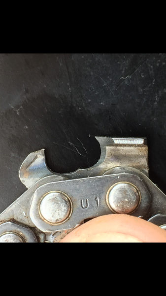

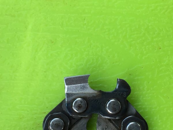

    To the OP, have you cut with any 3/8 chain you have ground with your 520.....I know that I hate grinding lo-pro/picco chain, just a pain.....
    Anyway I have the 520 and the USG....I like the 520 and you can get a chain to cut as good as a brand new, regardless of what anyone says.....before I got a grinder I was the guy who thought a grinder only burnt Chains and took off to much material....I am here to say I was wrong....the grinder is only limited to the operators skill level!!!
    I have learned ALOT about grinding this past year....my goal was to grind just like I file and get a chain as sharp as a hand filed chain....well I have accomplished that....I still hand file, so I needed to keep the same profile, “grind as you file, file as you grind as a friend says”!!!
    I have both stone and CBN wheels, both can do a great job....you just have to profile and clean the stone wheel, keep away from the black ring of death, lol....
    Here are some pics......
    9EAE6D13-B1F1-4BCF-9A3A-A3E258BC8EEF.jpeg 2DC19A86-D751-49F2-AB03-A8F4A52FD08C.jpeg A9943528-8965-4A12-AD3A-91AF8A76E1FA.png
    Horkn, 94BULLITT, huskihl and 4 others like this.

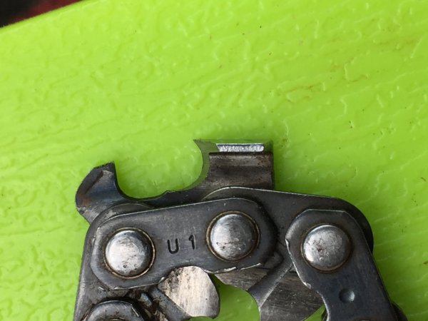

    Here is a picture of a cutter after I ground it....it shows that you can get the same profile of a file, if you get all your settings just right....
