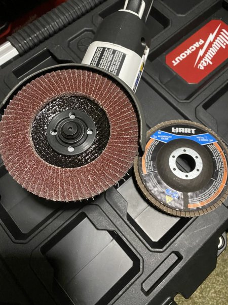

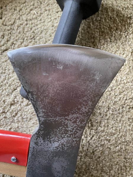

    I found a quick way to get my Axe back in the game sharp quickly, using my battery Hart Grinder/Sander using the 80 Grit Aluminum Oxide sanding disk.
    I used to spend hours with files and stones returning my Axe's to service, now using my vice to hold the Axe i have the job done in minuets.
    Just a few quick lite pass's does it without removing unneeded steel.
    It's hard to get a really good picture of the edge of the axe blade, but trust me it's sharp.
    Hart Battery Grinder&Sander also Hart Alu.Oxide Sanding Tool..jpg.jpeg Axe sharpened with Hart sanding tool.jpg.jpeg
