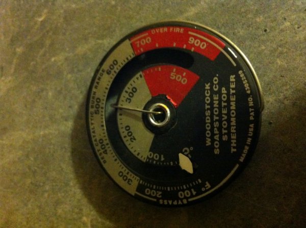

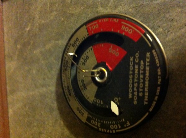

    Paperclip high temp indicator
    Idea Stolen from another thread.

    Now that's inventive! I'll give it a try.

    Me too that looks better than a piece of aluminum foil that usually ended up missing.
