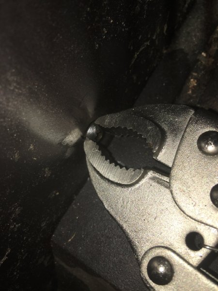

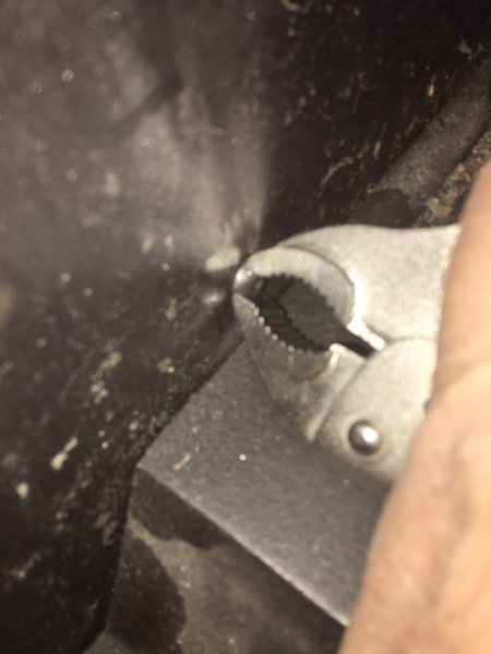

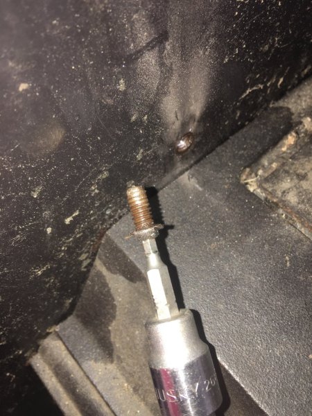

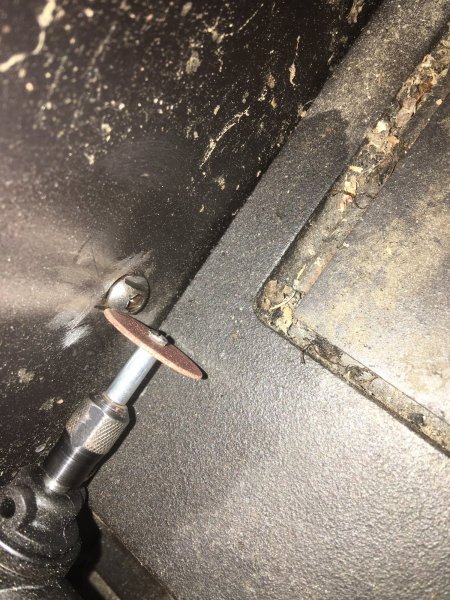

    My trick of the day was just to remove this bolt on the shroud just to get the stove in the door!
    The round head was already stripped in the sunk in head so the ratchet and the socket could not cut the mustard and crack that bolt even with wire wheeling and spray PB Blaster lube on it!
    So I pulled out the Dremel and installed the small cutting wheel on it and cut a flat spot on each side to get a grip with the vise grips and bingo!
    See Pics
    Pic 1 - cut the flats
    Pic 2 - attach the locking pliers
    Pic 3 - push and turn and heat a crack - Bingo
    Pic 4 - put the ratchet and hex head socket in and it is working

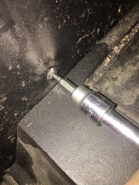

    Pic 5 - just keep turning

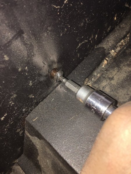

    Pic 6 - Bingo - It is out!!!
    Simple as that???

    The small button head Allen screws are nice looking but can be a pain for sure once the internal Hex goes away.
    Good one Don.
    I had one a while back on another job and simply dropped a hex head nut down over the button head and zapped it with the wire welder down through the nut.
    The was not enough room to get a grinder in the area and do much.
    These tricks are so helpful when stuff will not come apart.

    Great Idea Snowy! Thanks for sharing that! I will remember that one too. :)
