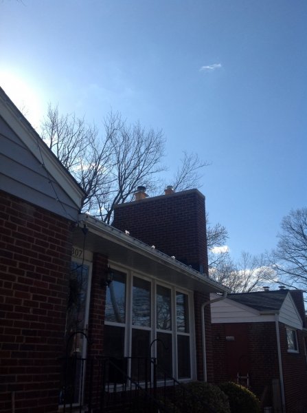

  6. fishingpol
    fishingpol
    6,502
    39,646
    Merrimack Valley, Ma.
    Do you have a stainless liner from the insert in your clay flue? Partial up past the smoke shelf?
    I dont see a chimney cap, so I'm guessing you may not.
    I've seen over the years that two different flues exiting at the same height can cause drafting problems on windy days.

  7. mrfancyplants
    mrfancyplants
    Mar 21, 2019
    937
    5,172
    South Carolina
    The previous picture was of the neighbors, just to show chimney height since we have nearly identical make/models of houses. I just went out and took a picture of ours, with the stove being connected to the left side. We had our hvac replaced a few years ago and they replaced the liner, presumably with stainless.

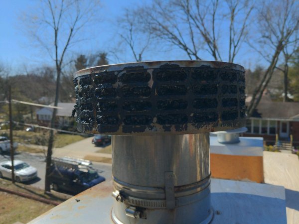

  12. brenndatomu
    25,378
    165,410
    This sounds like the classic plugged up flue...cap would be the first suspect...

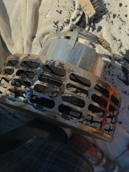

    Mystery solved I think. We’ll fire her up w some kiln wood tonight just to be sure. Thanks to all for the guidance. B2FD4A2F-C637-4833-8952-8A0268904417.jpeg
  14. Ralphie Boy

  15. Warner
    Warner
    Jun 19, 2017
    7,368
    47,706
    I don’t think I’d be calling that sweep again!
    brenndatomu and mrfancyplants like this.
  16. Eric VW
    24,584
    141,863
    You’d think a sweep woulda noticed that on the first go around.

  20. Warner
    Warner
    Jun 19, 2017
    7,368
    47,706
    Right! I guess he “cleaned” it from inside the house? The black flue cap should have been addressed the first trip. From your pics it looks like it should have been visible from the ground?
