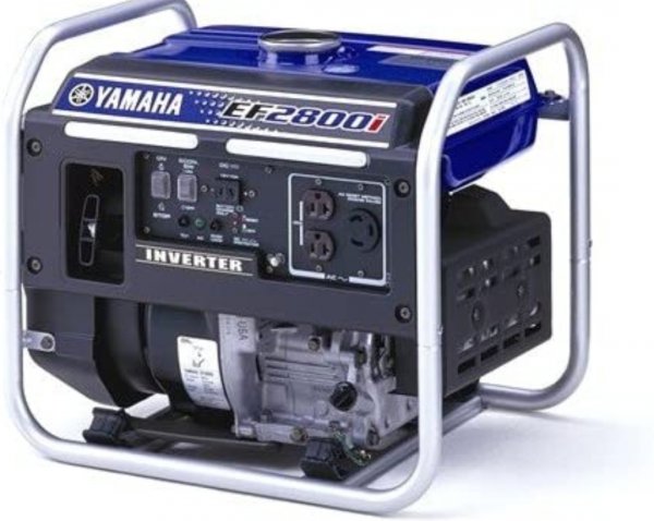

    This place sells tri-fuel kits for most gasoline gennys. I bought one for my ef2800i Yamaha, just didn't get the chance to install it yet.
    Generator Conversion Kits to Propane and Natural Gas.
    Stock pic:

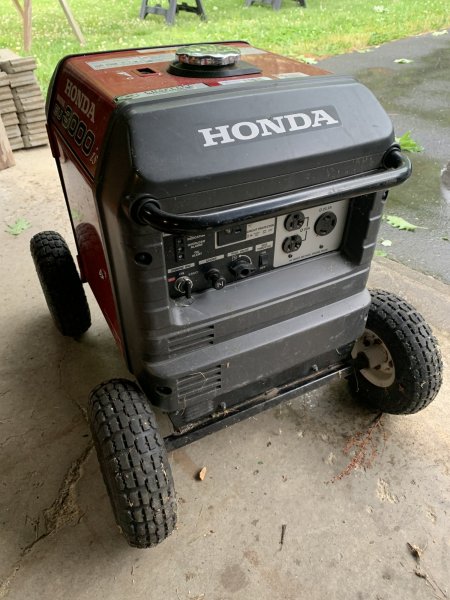

    image.jpg Super quiet, sips fuel in Eco mode. Only two problem for me is it won’t run the submersible well pump and other “necessities” in the house ( freezers and refrigerator).
    and the price tag…

    I understand the well pump. Probably 220. But 23 amps will handle a fridge and a freezer.
  13. Warner
    Warner
    Jun 19, 2017
    6,556
    41,502
    Yup, the well is 220 and the genny is not capable.
    it will run the house needs otherwise, my post was a bit misleading.
