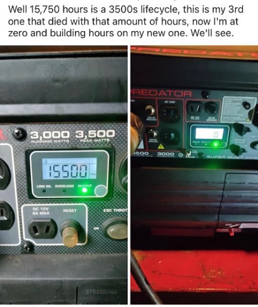

    This person said the generator runs 24x7x365 at his fish camp. He changed the oil every 500 hours or so using straight weight SAE 30. Was still running the original spark plug at 14k hours. Based off of some of the other posts the Predator generators seem to be hit miss though. Lots of CO sensor problems, luckily it can be bypassed though. I guess Powerhouse generators are clones of Predator generators which are clones of Honda's.

    14k hours on the original plug, I certainly believe. Plugs last forever in small engines that run well. There is just not that much energy in these little ignition systems to be severely eroding plugs, so the gaps don't open up much, and with the relatively low cylinder pressures, the energy required to jump the gap is low. And no need for multi-weight engine oil if the MF'r never cools down. :rofl: :lol:
    Wonder what the fuel consumption per hour is?

    So 21 months of non stop running per predator 3500. Over and over. Fascinating.

    Someone asked him but he never replied with a answer.Said it’s his third one he’s put 15k hours on. He mentioned that he’s spent about about 12k on gas to run the one with 15k hours. :jaw: Maybe that’s for all them ? I’m sure someone in here could figure the math out.
    The Facebook the group is wide open, you don’t have go through any kind of vetting process to search or read posts. The group is called Predator 3500/5000 Inverter/Generator. I searched on “blew up” and his post came across my feed. I was trying to find the 6k hour generator post.
