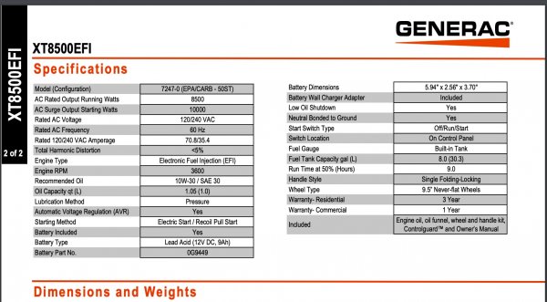

    I get the 5% from exactly where you say.... grid requirements.
    We don't know what Hondas can do because they don't publish the number. At least, not that I've seen. Have you?
    Here's the Generac model I was referring to. You see they publish THD <5%. Why not get something that produces clean power if you can? And why question cleaner power?
    Having owned generators the produce dirty power, and seeing the effects over time, I'm a believer.

    Lower THD is certainly better but not as important as you seem to think. It’s like emissions ratings on a stove. You don’t need to choose only the best performer. As you found, and for good reason, ultra low THD is exceedingly rare on these larger portable generators.

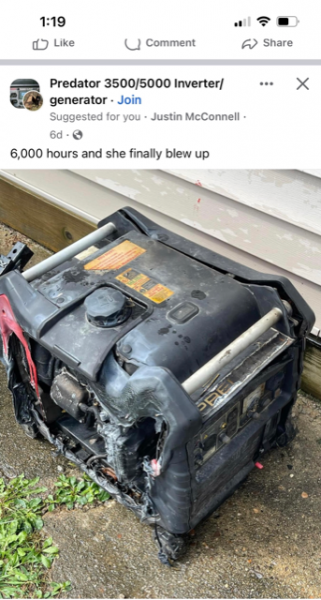

    I have a el cheapo Champion 3500 watt generator that's runs great. I however don't think it puts out the cleanest power ( lights flicker some ) so I've thought about buying a Predator inverter generator. Our power rarely goes out so I can stomach buying a Honda. Was at a friends house and he has a 3500 watt predator inverter generator and he said it runs great and is really quiet. He also has one of their suitcase generator for camping, and said it's super quiet too.
    Saw this Facebook post awhile ago.
