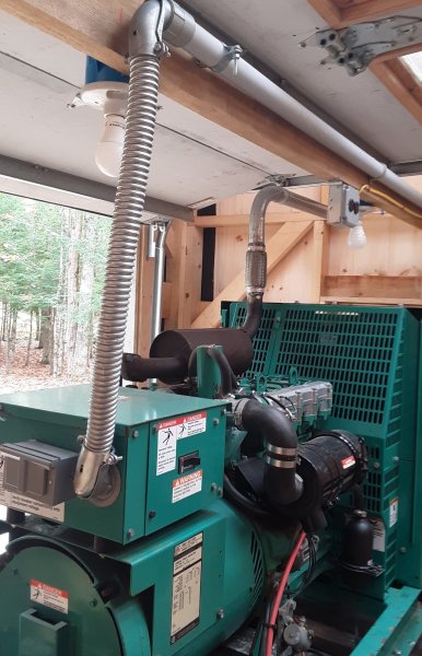

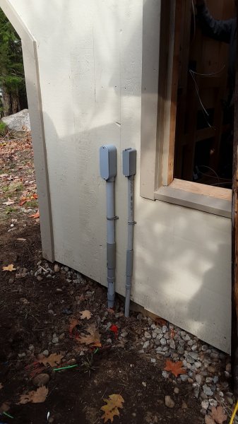

    Not much to show but some conduit. We put in a couple of lights inside, 2 inside plugs, 1 for the block heater and outside receptacle along with a couple of outside lights. 20201018_145511.jpg 20201019_142724.jpg
    Thanks for riding along with me
