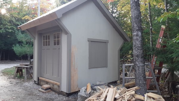

    Painted until my gallon ran out at lunchtime. I'm good with that, at least on this beautiful Saturday. 20200926_170824.jpg

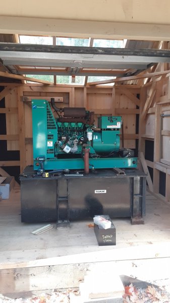

    You gonna run a stack for the exhaust? The would obviously help with fumes, but would help keep heat down as well.
    A piece of 3" stainless and a tractor flap would look nice on there....either through the wall or roof would work.

    Lukem I think that I'll head for the side wall, I have to leave room for the garage door to open and would just rather not worry about sealing up a hole in a roof exit.
    With a slight turndown in a horizontal position I won't have to worry about rainwater and I'll hose clamp a little pc. of wire cloth over the end to keep and critters out.

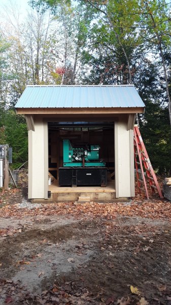

    Gotta get the exhaust piped outside next. My cousins, both electricians will be doing their part next week.
