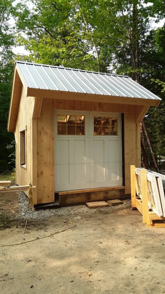

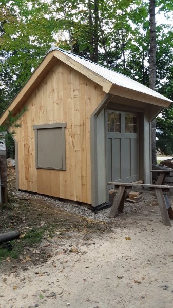

    Installed the overhead door that I found on c/l. 20200915_151910.jpg
    Next I'll trim it unless I decide to paint it first.

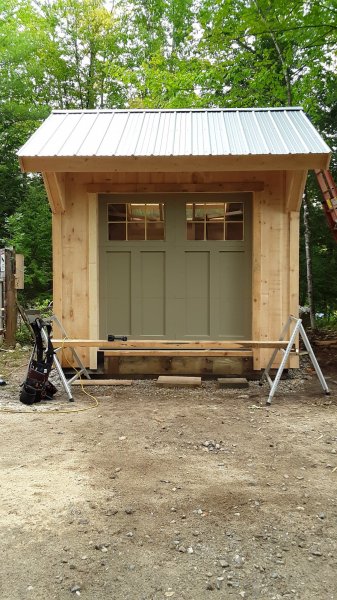

    As much as I love/hate painting 20200918_114010.jpg
    Just couldn't trim out the door before it had paint on what would be not accessible trimmed.

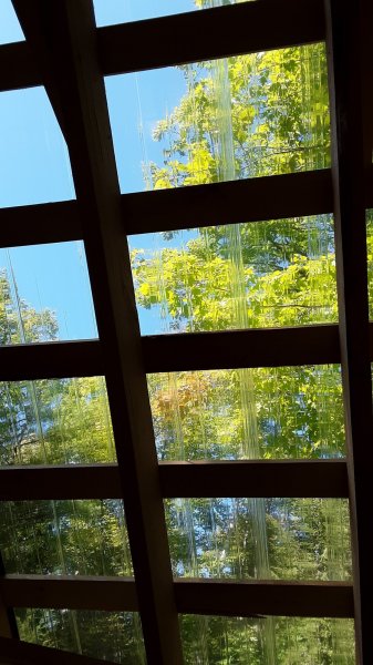

    How did you do the clear roof into the steel at the bottom of that panel? I would love to make a greenhouse with a roof like that to replace the crappy shed I have on the other side of my garden.

    That's a fairly new polycarbonate panel that's as clear as can be. It's a little
    "fuzzy" optically I think just due to it being formed to the profile of the metal. It's a long way from the old fiberglass panels. If you call around, I think "polycarbonate" is the keyword to include in your inquiry. :thumbs:
    I used it on the back side. It sticks out like a sore thumb and that side is away from my drive.

    Yeah that would be awesome for a greenhouse roof. That should shed a lot of light in your situation, provided it's daytime. :thumbs:

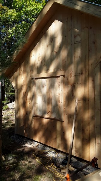

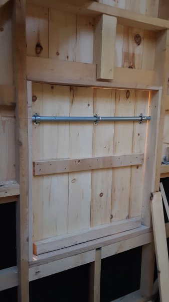

    Built the windows that are not windows to allow airflow for the generator. It's crude but works well and they'll only be opened when the generator is operating. 20200919_083704.jpg
    I just drilled a 1 1/4" hole through the jamb and stud, pushed through a pc. of emt and clamped in to the back of the wood.
    Started painting the trim (corners, window and door trim and eventually soffits and fascia) the walls will get a little lighter color. Not sure what I'll get to paint wise before cold.
    Chaz, Flamestead, Stinny and 7 others like this.

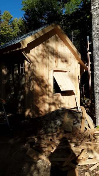

    Painting
    I run a orbital sander across anything getting paint. Not real fun but some of it is heavily textured or sorta "fuzzy". It uses the heck out of paint and holds dirt, spider webs, etc. A light sanding helps with that.
