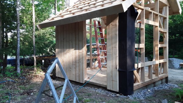

    Got all the overhangs built. Pulled away what I had for scaffolding and started the siding after adding some blocking where my angled eave soffits wouldn't let me nail the top of the siding boards. My lack of thinking. :whistle:
    I had some tar paper hanging around so I'll put a strip across the bottom and at the corners.

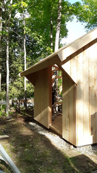

    Labor day weekend, more details. I like this old traditional look. A little tedious but more interesting than just shooting on boards. The 2nd one was was easier than the first one now that I know the 3 super secret angles to run a 45* into an 8/12 both long and short :rofl: :lol:. The last 2 on the front will be "cake". I still need to frame (down) for the front overhead door. 20200906_162121.jpg 20200906_162139.jpg

    One more wall left. But there's still a lot left to do. I need to figure out my idea for airflow through what look like windows on the end walls, they'll be more like a panel that will swing out similar to an awning window. They'll need to be opened during operation of the generator. Then some exterior trim (corners, door & the windows that aren't windows) and lastly the garage door. That is excluding the roof, that I hope to have before the weeks out. 20200908_172122.jpg
    The generator will sit in the middle, inline with the "windows" with the airflow in one side, through the radiator and fan then exit on the opposite side.

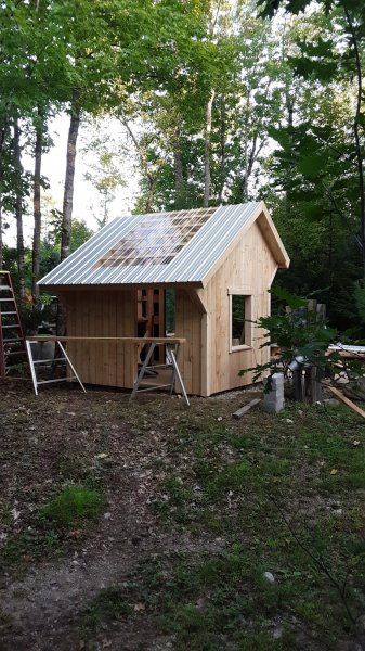

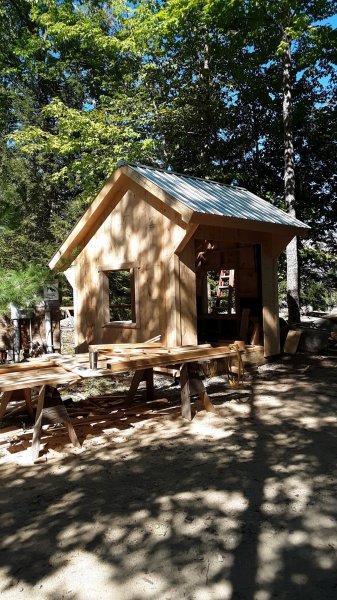

    Roof:yes:
    Got all the corners on and jammed and trimmed the openings for the "windows".
