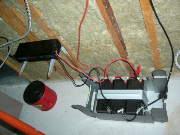

    I made a battery back-up system just for my pellet stove. It works like a charm and have enough power to supply until I get home to power the generator. Mind you, I paid close to a $1k but it's a very good puresinewave system. The previous Noma back-up system I had was a piece of junk but it saved my butt a few times until it died. The generator way to go is with a Yamaha or Honda for electronic clean power...

    Pic to show the set-up! The battery pack has been changed to a couple of Trojan batteries. The batteries showing are what I salvaged from the junk Noma system until I received my Trojan's.
