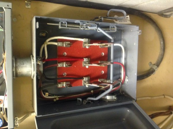

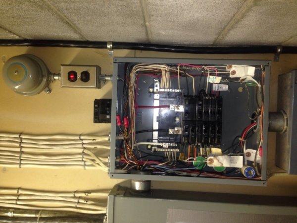

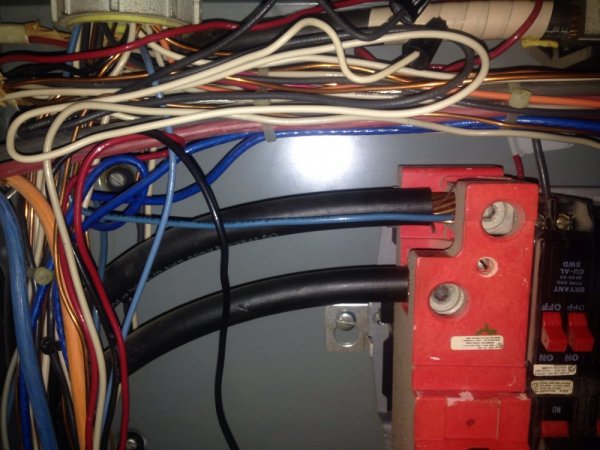

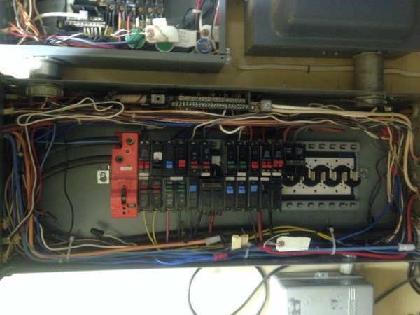

    Sure... Why not?
    If there are bad things lurking in these panels, I'd like to know about it. Just remember, I didn't do it.:D

    Bottom left picture, that blue wire tied into main bothers me

    Whats that switched alarm bell type looking thing on top of the sub panel?

    It is connected to the mains so when the power goes out he flips the switch to the gong and turns off his main and runs the generator. When the power comes back the bell goes off telling him powers on until he flips the switch to stop it. It very smart setup and I will be doing something similar with mine :)

    That runs to the gong in pic 1.... is there even another way to do it?

    BTW: this is a 1260sq ft single story ranch. 3 tiny bedrooms. There is enough wiring in this place to run a house three times this size.

    Does it do anymore than leaving a light or the tv on? The switch usually does not get wired to everything in the house. So when power comes back on if you leave something on that is not wired to the breakers the generator is wired to.........
    Does it cost more dough?
  18. MasterMech
    9,648
    26,039
    Greenville County SC
    Costs more than a light bulb but it was all here when I bought the shack.
    The advantage is if you were to shut off the mains during an outage to protect from a surge when power is restored. You would not have power anywhere inside the house if your mains are open.
    The genny is brawny enough to power the whole damm place and then some as long as you keep it fed. I would rather have it feed the whole panel but it is what it is. It will run two 12k, and one 6k window AC with enough nut left over to start the deep well pump. :smoke:

    I know with my setup I have a Interlock so once the power goes out I flip off the main breaker, move the interlock and flip on the generator breaker(When it is setup this way there is no way to know if the main has power to it). With the setup he has the wire is before the breaker on the main line in (he also mentioned that the line is protected by Edison base fuse) and goes to the gong.

    It will work however the wire from the main is unprotected to the fuse which could pose a major fire hazard in the event of a short before the fuse and the main lug is rated for only one wire.. Just saying it is a code violation..
