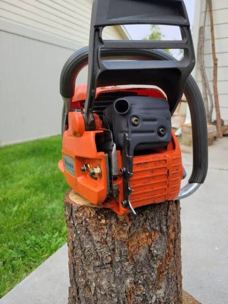

    A guy my son worked with gave him a Husky 345. Looks to be in nice shape. I'm gonna mess with it in a while. Can't go wrong with free stuff!

    I think it needs a oil pump. It's not getting oil and the teeth on the pump are worn down pretty good.

    Free is usually good, lol. That is a little brother to my favorite of all the plastic homeowner saws (350). There are 3 major known issues that need addressed to keep it reliable. First is the muffler bolts. They are prone to loosen and leak hot exhaust gasses directly on the case, melting it. Best fix is a muffler bracket off a 346 w/ one of the “ears” cut off. I’ll find a pic.. Second is the plastic intake clamp. If that saw has one, look into getting a metal replacement. Third is the cylinder riser bolts (on the 350). Since the 345 doesn’t have that riser, I’m not certain that those bolts are still an issue but.. if you want to tinker, fast forward this video to the 24 minute mark to see where they are located. On the 350, I could remove one at a time w/o removing the entire gas tank, then I used red loctite on the threads and retighten. Cheap insurance to prevent one or more potentially coming loose allowing an air leak. The 345 cylinder has the riser cast in.
    This pic(not mine) shows the 346 bracket to prevent the muffin from coming loose.
