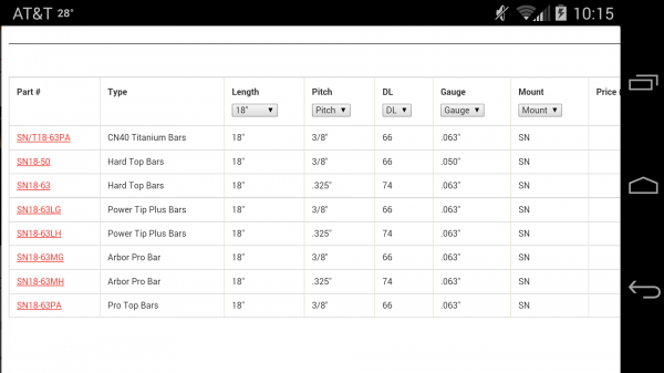

    I see, so here's the 18" GB bar chart for my 029.
    What I get is that I don't need to use a .325 chain. I could use a 3/8 chain with corresponding link #s. All but 1 bar is .063 gauge so that pretty much isn't a variable.

    If it's a Stihl bar on the saw now, I'd bet money that it's .063" gauge chain.

    Yep, stihl bar now. But 16", and I want a little longer bar. So I'll go 18".
