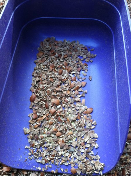

    Hi Snowy,
    I see you have masher fingers like mWE. :rofl: :lol:
    What sort of nut shells and do you grind them up? THey would need to be fairly fine to flow?
    Shells would be pretty high in ash too wouldn't they?
    Do you dry em out?

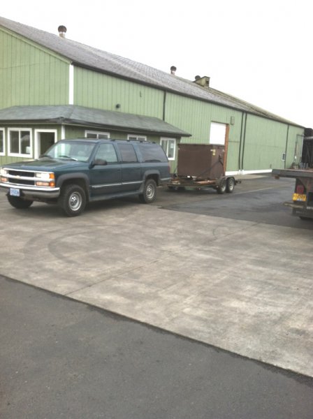

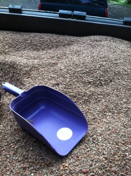

    Chicken.
    We use hazelnut shells.
    The nuts are dried, cracked and the meat removed.
    The remaining material is run out of the plant and goes through a trash fan to break it up.
    Stuff is nice and dry and fairly coarse in size with many pieces the size of a fingernail.
    The stuff has about 2 x the ash of pellets, but the price is a penny and a half a pound.
    I heat a 2400 sq ft home for under $100 a season
    We fill the dumpster at the plant, then bring it home and put it in barrels and store indoors.
    Here are some pix
    More waste biomass products, not much different than the pits you folks use.
    Stoves need a bit more tending as there is a tendency to clinker some.
    Also the shells do not roll down the hopper as easy in some stoves.
    Not a big worry.
    For the cheap $$$$$$ I can put up with the slight issues.
    Clean stoves more often.
    Our little Whitfield gets a cleaning every 3-4 days and the big Whit is Weekly.
    Only exception is if it is real cold, then we will do a "Quicky" hot clean (Fire barely out)
    and then when weather permits, cool it off and do it up well with a complete clean and a suck with the leaf blower.
