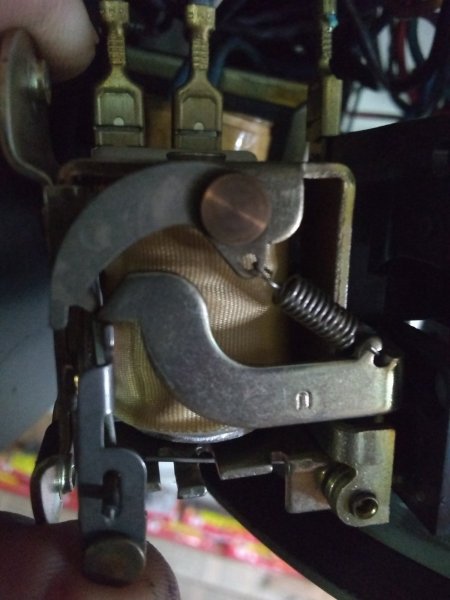

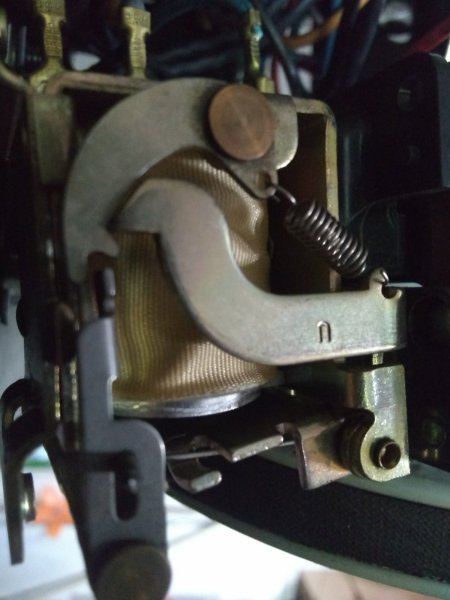

    Ok, I found some relay numbers on top under a light coat of dust...looks like a VERY obsolete part, can't even find any NOS anywhere...its a Midtex 48-34Q100, there was one on ebay a couple months back, too much money to be worth foolin with though, IMO.
    This is an interesting relay...its what changes the rotation on the motor.
    In this position the one contact is NC
    After the relay activates once, it ratchets to this position, which has that 1st contact NO, then when you activate again, the second contact makes...rinse, repeat. IMG_20210716_093338324.jpg

    Would you say that relay is part solenoid?
  18. brenndatomu
    25,337
    164,977
    Yes
