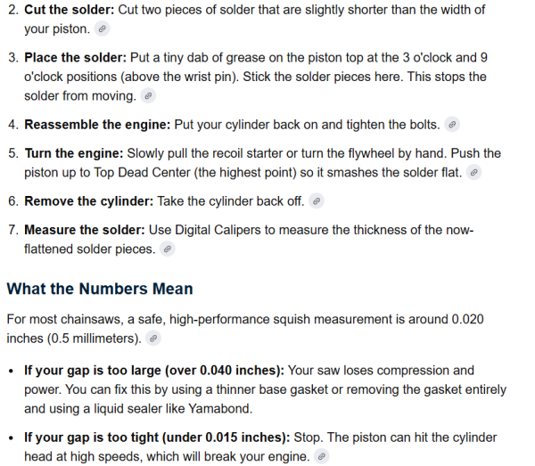

    I've never actually measured squish on a cylinder before. Can I or should a I do it on this assembled engine? I do have some digital calipers.

    I'm for sure not and expert...you need a length of solder...6". Pull your spark plug and insert the solder. Cycle the flywheel with intent to smash the solder between top of piston and side top of cylinder wall. Remove solder, measure thickness of smashed solder. This is the way I learned to do it which is probably the redneck way.
    My way is sortof close to what the AI says. I didn't pull the jug to do it. Worked for me once in past. Saw came away with 165lbs. (wasn't really low to begin but I was tinkerin') You just gotta make sure your cylinder won't slap top of jug.
    I'm betting that you can pull your cylinder gasket and bring that compression up a bit. (Hondabond sealant instead of gasket) The pros shave the bottom of the jug to accomplish same.

    Yup, that's how I do it...bend the solder so you can push the tip over against the cylinder wall before turning the crank to and past TDC.
    Some (most) combustion chambers have less piston/head clearance over by the cylinder wall

    I forgot about about the piston rock thing...I measured mine "to the side" in other words, the solder parallel with the wrist pin, that should minimize how much the piston can rock, giving you a false reading...at least it works on a new/tight engine, in my mind anyways.
    IIRC I took my squish down to .020" or so...which is about the minimum on a 660, from what I've been told...so far so good anyways.
