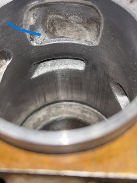

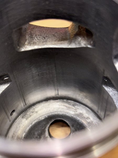

    I had some time this evening to clean the saw up and get ready for the new piston. Wishful thinking on my part. When I took a good look in the cylinder and cleaned the oily mess out of it, I noticed what I had hoped was some transfer, BUT... it's not. The cylinder is a paperweight. several nail catching scratches look to be through the plating. The casting looks cracked in both transfer tunnels.

    I already have bearings, seals, gaskets and new O-ring for the bar oil pump so I'll take it down and replace all that stuff and get that bottom end clean while I'm waiting on a cylinder. Not sure what I'll go with yet, but I missed out on a flash sale of an OEM cylinder and piston kit the other day when I ordered just the piston... I should've jumped on that.
