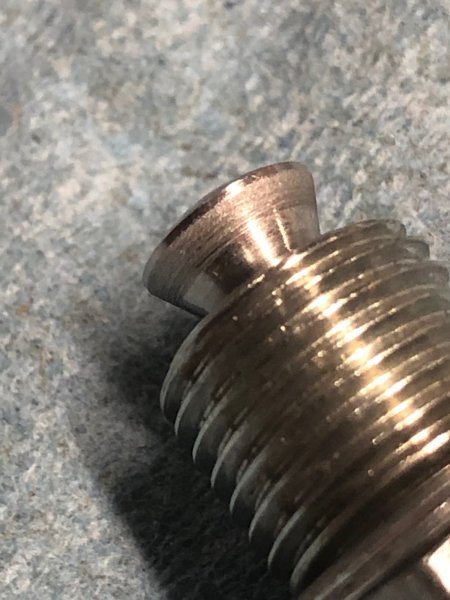

    I used some valve lapping compound on the leaky decomp valve and cleaned it out with carb cleaner and lubed it a tad. I pressure tested it and it seems to be good now. I'll keep it for a spare and test it in a cylinder next time I pressure / vacuum test a saw with a decomp in it. I know the used one I put in this saw held pressure and vacuum during testing no problem.
    I would think these would be somewhat self healing since it gets hammered 9,000 times a minute while you're cutting wood. I have read that peak pressure in the combustion chamber of a saw can reach upwards of 2,500 psi. But I don't have a whole lot of experience with them as "good" or "bad".

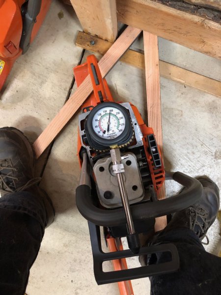

    Compression was 180 on my cheapo tester that you have to hold on the cylinder, hold the saw, and pull the thumper cord. This was with 2 tanks of mix through the saw so far and I'm sure the new caber will seat in a little better with some more run time. I'm just happy it runs better than before and feels strong.

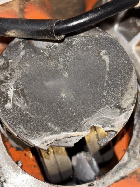

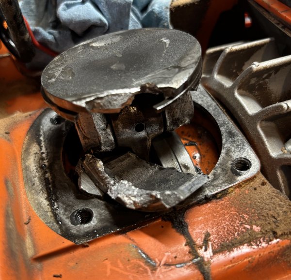

    I've run this saw hard and cut several LARGE trees with it using every bit of the 32" bar it wears. Usually 40:1 red armor. I was noodling a blown down 22" sugar maple today and it was running great then the saw went HARD STOP... Stuff rattling around in the muffler. I opened it up and the piston had let go by the exhaust port. I was assuming it hung a ring as part of the ring had snapped out and was in the muffler. Oddly enough, I can't really see any damage to the cylinder at all even around the exhaust port where I thought there would be severe damage from a hung ring. I did use the lightweight HyWay piston when I built it and lightened it even more so it's possible it just came apart on it's own. The circlips were in place so they didn't come out. I'm not sure I want to go back to a HyWay piston although this saw has performed well for 2 years of firewood use. It hasn't been used daily or even weekly, but when it is in use it's usually for 2 to 6 tanks of mix for a hard days work.
    Parts in muffler, piston chunks and part of the caber ring.
    top of piston. Was I running too lean??? Spark plug electrode gap was hammered closed from debris in the chamber. But no other damage in the ports or cylinder was found. Even the chamfering still looked good.

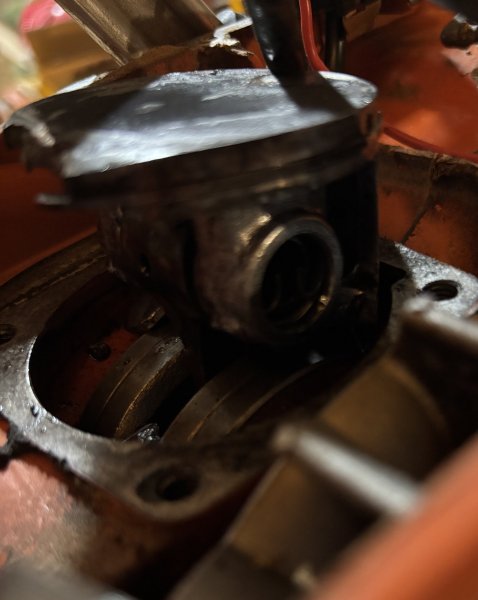

    Front of piston GONE...

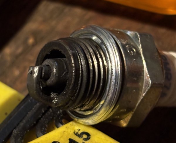

    spark plug. Saw was running great, but I got lazy and did not check the tune on it today. It had run fine last time I had used it so I never even thought to check the tune... I need to form better habits... Plug doesn't look lean to me, but I'm just a hack, not an expert.

  10. Eggshooterist
    Eggshooterist
    Dec 19, 2021
    7,020
    38,134
    Erff
    Wow Monte. There are not signs of piston crown pitting, that I can see, that would indicate a long term lean condition and the plug actually looks like it was quite rich. It looks black and wet, not the cardboard box tan or a bit darker you look for.
    My guess is you either took to much material off the piston, like you stated, or you got a piston that was at the low end of chicom quality.

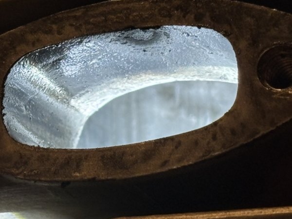

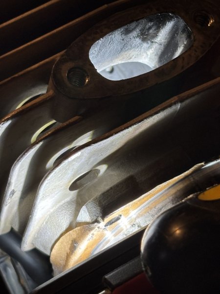

    Out of curiosity, for unrelated reasons, what does the exhaust port look like?

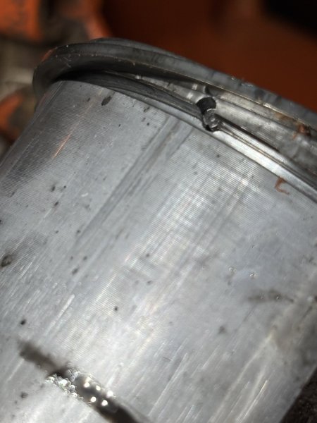

    Is the ring locating pin still in the piston?
    Screwloose, eatonpcat, MAF143 and 2 others like this.
  15. Eric Wanderweg
    8,772
    69,826
    Yikes. I see you thinned the top of the piston in a couple spots on the exhaust side to match the port, but it doesn't look like you took so much off as to compromise things. I'm also curious about the ring locating pin too. I can definitely imagine that maybe there wasn't enough of a press fit on that from the factory. After enough heat cycles and heavy loads that could've backed out. Voids in the casting is another possibility, or maybe the aluminum alloy composition was never quite right either. Whatever the root cause, it's a real bummer. Hopefully you can flush out the cases and be off cutting again with just some top end work.
    Screwloose, eatonpcat, John D and 3 others like this.

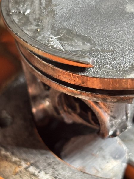

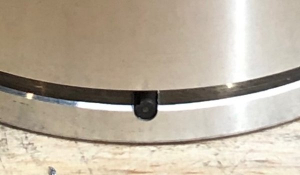

    The ring end pin looks to be snapped off and the ring was rotated around the piston till it got to the exhaust port and hung. In this pic, the ring has been pulled out of the groove, but is still on the piston, just up out of the way so you can see the pin has either snapped off or worked itself in, but I don't see how it could go in...
    The end walked around to the exhaust port. When I took the saw apart this end was still in the groove but the other end of the ring was snapped off and inside the muffler.

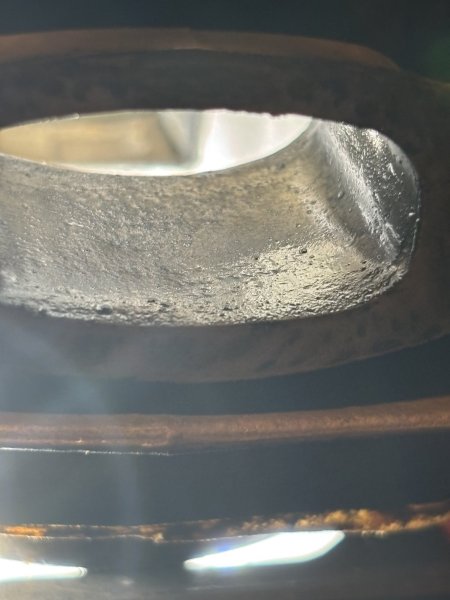

    The exhaust port has some carbon and is a little damp but no damage that I can see.
    bottom of ex port

    Speculation on my part, but looking at that pin, I'm wondering if I didn't get the ring end aligned correctly when I assembled the saw. Could the ring have moved a bit when I compressed it into the groove for assembly and pushed the pin deeper into the piston while inserting it into the cylinder? Then the ring would be free to walk around and eventually get into a port? I'm surprised that it made it past the upper transfer port without hanging. The upper transfers are pretty big on this saw, pics back in post #25. Did I screw up royally and put the ring end totally wrong about 1/3 of the way around the piston?
    When assembling, I'm very aware of the ring end and getting it on the pin. I can't imagine being off and able to get the cylinder on over it and I'm pretty sure I didn't assemble it on a six-pack night... :drunk:
    It makes no sense to me that the pin could be pushed into the piston farther. I would think the pin would be bottomed out in the hole during manufacturing... But then again, this piston came from where???
    But here is a picture of the piston prior to assembly and it clearly shows the end of the pin with that nipple on it out where it belongs.
    I'm thinking I'm going to have to chalk this up to pilot error and blame myself for installing the ring incorrectly and mashing the pin further into the piston although I wouldn't think that could be done with a plastic ring compressor... I must have gotten pretty distracted by something to miss that!
    I'm fired and shouldn't be allowed to own tools.
    I'll mail in my MAN card with no expectations of a refund...

    I don't recall ever having a pin move...but never used Chinese pistons in bike engines though either... manufacturing issue IMO

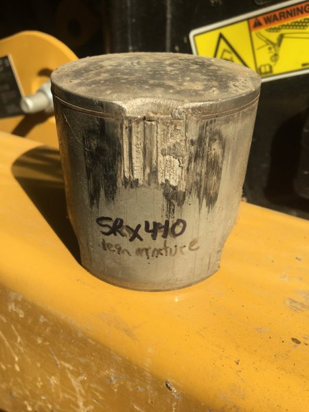

    IMG_0632.jpeg This is a classic lean mixture failure. ^^
    I wouldn’t be surprised that your piston failure was initiated by the ring pin getting hammered until the ring ends slipped past it. I have seen that happen on cheaper two stroke pistons, and you had the added stress of a hopped up engine. I’ve also seen a 2 stroke ring crack just for the fun of it and that can lead to exciting things hitting each other.
