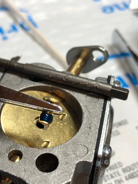

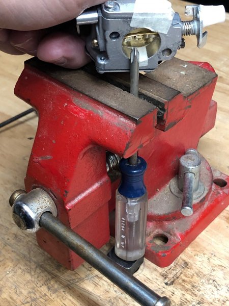

    I did some carb work this evening since my 3mm brass screws for the choke and throttle plates came in.
    I replaced the both plate screws and used locktite. The choke plate screw had different threads than the throttle plate so I had to tap that hole. Had to be careful to line up the choke plate correctly so it's notch clears the Hi jet nozzle in the venturi. The throttle plate notch has to line up with the line of low speed jets in the bore. They are in line with the Hi jet nozzle.

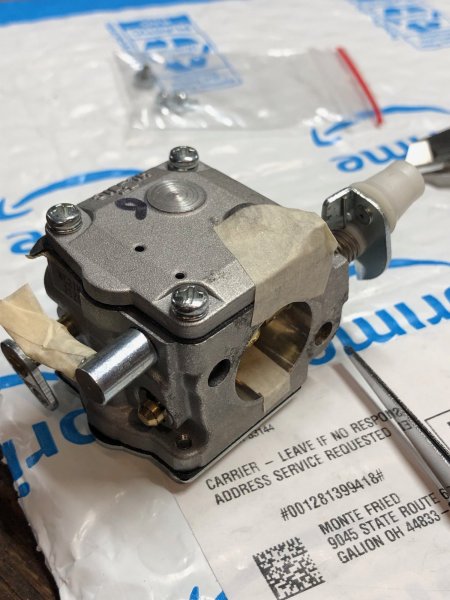

    I taped off all the fuel passages, pulse hole, jets in the bore, and atmosphere vent on the metering diaphragm side before cutting the metal.
    Then I thinned the shafts and took out the screw length and flattened the heads some. Should flow better than before... Not a pro job by any stretch, but It'll do for this weekend hack...
    Being the belt and suspenders kind of guy, I also peened the threaded end of the screw after they were ground off. This along with the locktite should keep these screws in place. I like a saw that eats wood, not carb screws. I put a screwdriver in a vise to support the screw head in the shaft so punching the other end doesn't stress the shaft or carb at all. I tried to get some pix of the punched ends, but my photography skills are rather limited... I'm pretty sure the tape kept all the brass chips from the carbide cutter out of all the places I didn't want them getting into.

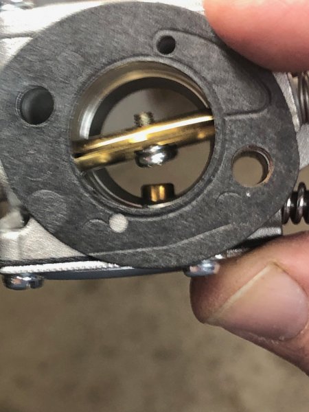

    This should have a little more flow than before. This is what it started with.
    I know there will also be gains in the throttle settings once the carb is back on the saw. The WOT stop lets the plate go way past center so that will get fixed and also will be checked out to ensure the linkage opens it all the way. Those are easy adjustments on this saw.

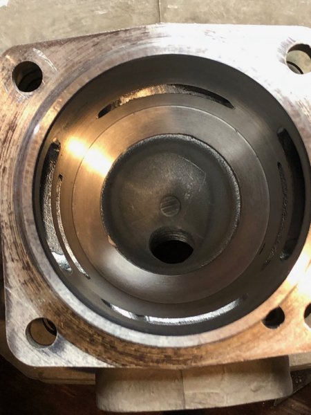

    Ethan called this morning and said he had time today. He cut .040" from the base and .032" from the squish band.
    The .006" base gasket will get used for this build so the cuts were based on that and targeting the upper transfers to end up at 121* or 122*. I don't have a right angle tip for my grinder.
    Then I will be able to grind the exhaust port with the target of widening it to 35mm and raising back up to 100* to get a duration of 160*.
    I also will adjust the intake timing by removing skirt off of the piston to lighten it as well.

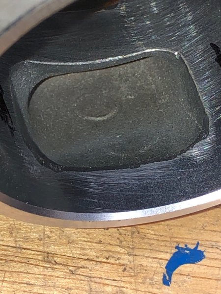

    Cut cylinder before grinding. I sanded .008" out of the squish band to get through the plating so it wouldn't mess with Ethan's tooling on his lathe. He cut .024 more out.

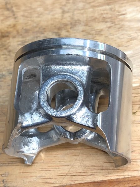

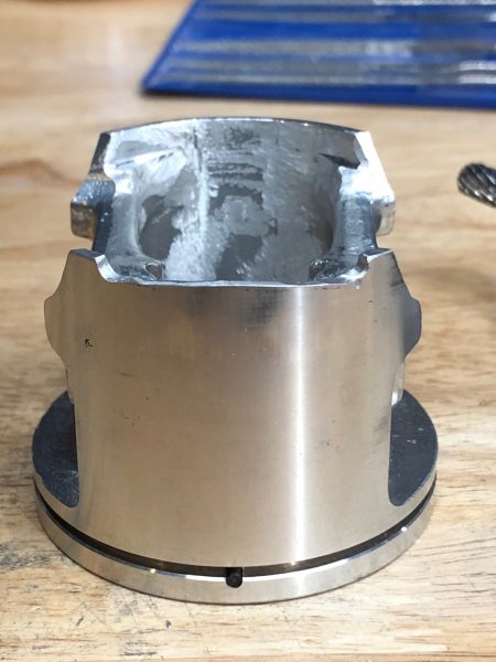

    I opened the windows on the piston a little and got rid of casting seams and sharp corners.
    I marked the intake skirt to match the intake port floor with the timing wheel set for 160* of duration. Then I cut the skirt to match it to get the timing and lighten the piston at the same time. I left the "ears" to help keep the piston rocking to a minimum.
    I matched the piston top edge to the exhaust port instead of making the port top flatter. I'd rather not hang a ring by getting a wide exhaust port too flat. I had to do some tweaking to this after the picture was taken to get it to match better. This pic is from the first pass.
    The piston ended up another gram lighter after these modifications.

    165,439
    One of those spring loaded punches works good for peening carb screws
    Screwloose, MAF143 and Eggshooterist like this.

    North Central OH
    I have a couple of those punches I use for laying out stuff. I never thought of using one of those, although the ones I have probably wouldn't fit down the bore of a carb. They're kinda short and stubby...
    I did need 3 hands to hold the carb on the backing screwdriver, get the punch where it needed to be, and whack it with the hamroid... I'm used to working alone and some of the Rube-Goldberg set ups I come up with can be entertaining...

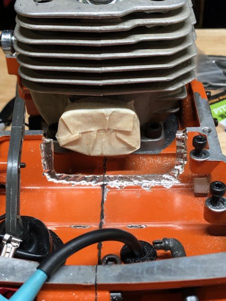

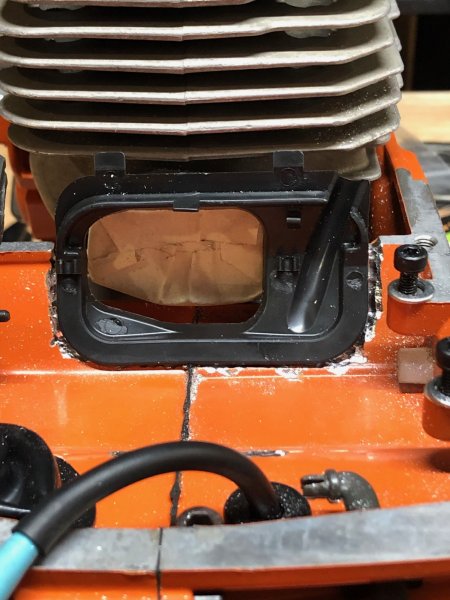

    A few pix.
    Intake box clearance had to be cut. Not beautiful, but it works.

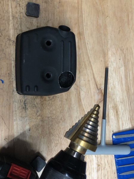

    Added a second output. It doesn't look like it in the picture, but it is angled a bit to the left and up.

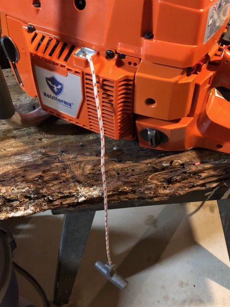

    I was gonna do another heat cycle while checking the wood stove at bedtime... but Sum Ting Wong!!!
    Probably an easy fix. But still a fix...

    Is it a correct assumption that this may be a symptom of the cord being too short? The center hex head cap screw inside had become super tight and wasn't letting things turn properly. Can this screw get tightened when hitting the end stop when the cord is pulled all the way out?
    I'm not familiar with how these work internally so I'm curious to find out more as to why this happens.
