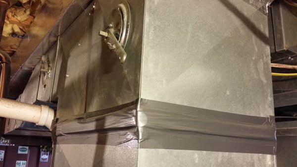

  5. DexterDay
    DexterDay Administrator
    12,411
    31,636
    Northeast Oh
    I installed 2 manual dampers. Much easier. Although that deems the LP furnace useless unless we manually change them, but we only use it for A/C anyway. So it works out.

    Btw, any pics of your damper set up? I don't have plans to run the LP at all, unless we're gone for an extended period of time, but I'd rather not rely on the high limit switch in case someone (aka ME) screws up and lets the furnace turn on. It would be nice to have a damper will open automatically.

    When I use the furnace, the freestanding stove upstairs will kick on a little later. I leave the stats set 5° apart.
    They are not a 100% positive stop (no seal like an actual back draft damper) so I lose some warm air (a few percent) out of them, but it works for me.
