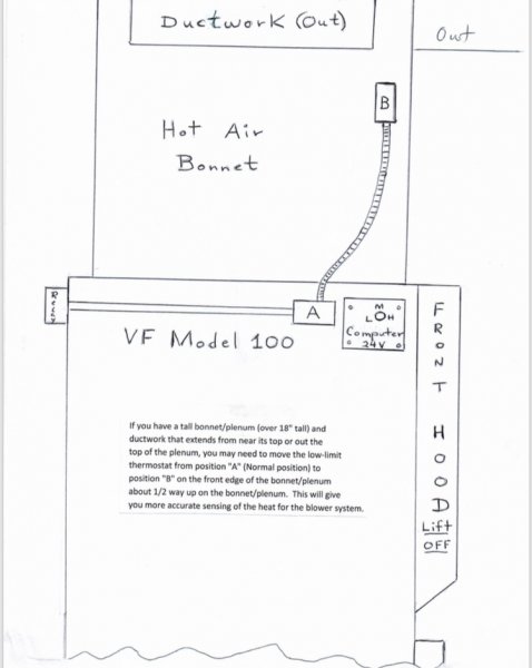

    Dale sent me a diagram about moving the low-limit thermometer up on the plenum. This is going to be necessary as my plenum is 35 inches tall.
    From your picture it looks like your low-limit thermometer is located on the front of the bonnet. If so, how did you go about choosing that location?

    I actually have two of them. The one you see on the front is where I originally put it but then added one to the very top of the plenum, pretty much right over the top center of the furnace. The one on the front is now where I have a much higher temp one which acts as my emergency switch to power a different winding on the blower in case the variable speed controller ever craps out.

    I sure did. Moving the low-limit thermometer up to the front of the plenum made a huge difference. I also traded my Dad for some wood cut to 20 inches. Those two things greatly increased the burn times. Overall, I am very satisfied with the performance. Thanks to you and JRHAWK9 for your suggestions!
