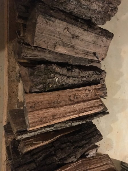

    Another thing that isn't helping is the moisture of the wood I am burning. It's dryer than a popcorn fart.
    I stored it inside in preparation for the install. On fresh splits the walnut and oak is reading from 10-16%

    Yeah I have the "too dry" wood issue too, Daryl told me that as soon as he heard I had 3 year + CSS wood pile...I been throwing in a few splits from wood that I just CSS this past summer...it seems to help calm down "the incinerator". :rofl: :lol: I hope they don't kick me off FHC for saying "too dry" :startled:
    The other thing that helped was using larger splits. I was fortunate enough to have some stuff here that was split really large originally intended for my Yukon furnace...cut 'em down to 16" long and they work pretty good in the Kuuma.

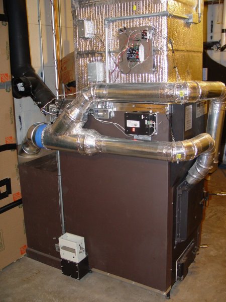

    Doesn't look anything too fancy, it's definitely a function over form setup. Nevermind the cardboard return air.... :rofl: :lol: I use an open staircase for my cold air and did that to temporarily raise the intake of the cold air to the basement ceiling in order to pull in warmer air instead of the cold basement floor air. It worked so good I left it as is and then contacted a few people about making a permanent tin one. Well, nobody got back to me with a price after they were here to give me a quote so I said, "screw it". Red Green would be proud!
    The variable speed controller is mounted on the side of the plenum. This is something else I plan on cleaning up, as I have three RIB relays I will be using to control the blower in certain situations/safety precautions.
    Tempering tank setup from when I was first installing the furnace. Do you have the optional water coil?
    View attachment 152735 [/QUOTE]
    Looks great to me. Redirecting the air off the face of the furnance is an excellent idea!
