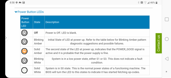

    Ok on dells site. Entering the service tag just says it's out of warranty.
    There's this walkthrough though..
    Blinking light decoding.
    wildwest likes this.

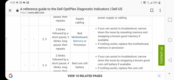

  16. Horkn
    29,266
    167,108
    Woooooooohooooooo!!!!!!
    Success!!
    I followed the walkthrough.
    2 blinks then 3 blinks.
    Reseated the RAM. Voila!!!!
    Chaz, papadave and brenndatomu like this.
