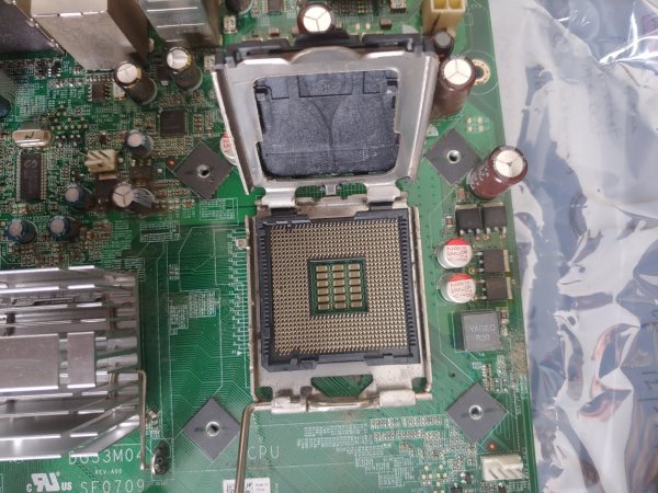

    No, I just swapped the old stuff. Will it boot if there is no ram? There's 4 ram sticks. Do I need to have them in pairs, or particular slots?

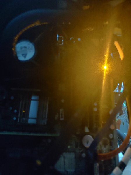

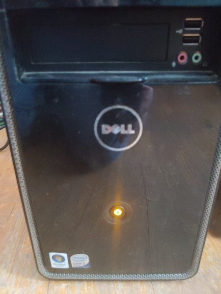

    Yellow light is on the motherboard and on the front of the case when I attempt to power it up. The CPU fan does not spin.

    No ram=no boot. Bad processor = no boot. Bad fan = no boot. Sometimes, not often, bad video card = no boot. If there is onboard video, take the external video card out of the equation.

    The yellow light in the mobo
    This led comes on as soon as I turn the PS switch on. It goes out after a few seconds when I unplug/turn it off.
    And in the power button
    brenndatomu, In the Pines and Chaz like this.

    I don't think this unit has onboard video board. That's a separate card that I swapped over to the new Mobo. I think that led in the mobo tells me the power supply is good. Right?
    I'll try switching RAM around.

    Light on the motherboard is a sign that there is power. Suggests the problem is not the power supply.

    This seems to be a problem, and if the fan was dying it likely took the processor with it.
    I don't think the processor can even run a second or two without a fan. They generate a lot of heat.

    Do you have any parts other than the power supply you can swap out for testing?
    a spare video card by chance?
    does the cpu fan spin at all when you hit the power button?
    they will usually (iirc) do a quick spin up even in a non-boot situation. That should rule out if the cpu fan is bad.

    Ok, I'm back guys. I think this may be the issue. Chaz the fan on the cpu doesn't spin up at all. I do have an old Dell desktop that this one replaced in the basement. I'll see if there's a fan I can steal.
