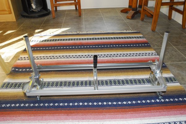

I am getting ready to order the 36" Granberg mill, as well as the prefab aluminum rails. I am all set with a saw, but I have a novice question. -Assuming the logs are clean, how will the chain hold up on Frozen hardwoods? Hickory, Maple, Cherry and Ash to be specific. I am wondering if I should hold off on spending the money until spring makes sense or not. We are at that onset of the frost period, so it seems like a good question to ask. Thanks

Guess I will order the mill setup soon. Just not sure what direction I want to go, Granberg, logosol, etc
If you were thinking about something in the logosol w/ stand price range, consider the Norwood portamill as well.
