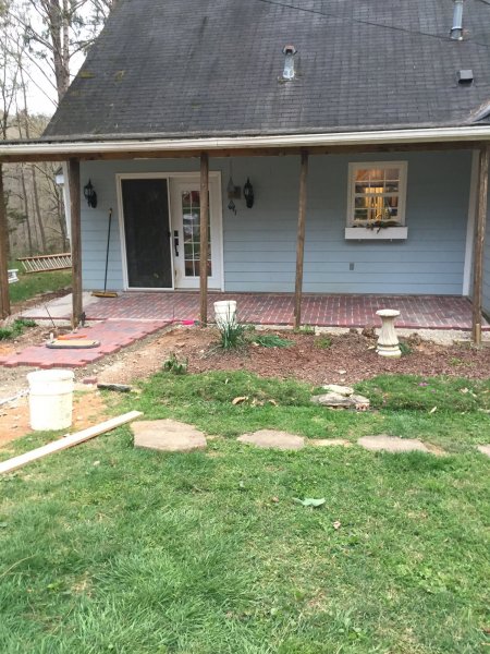

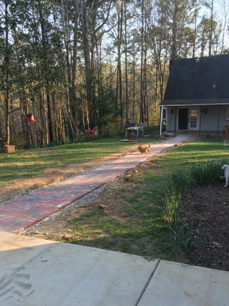

    Finished the porch yesterday and finished grading/packing the sidewalk base then knocked out all the sidewalk screeding this morning. Finished all the brick laying and cutting and sanded it once. Just need to nail down the edging and I can reset the porch posts.
    BF8CB4A9-D199-4D1F-B165-A9F02608A497.jpeg 99307859-E3DB-4036-94FC-8E98D836722A.jpeg

    Super nice job basod! I'm gonna do a small area like that about 12'X12' Been watching and learning the suggestions! :yes:

    :jaw::bug: wow you work fast. That looks great.

    That really looks nice basod What a lot of work!

    Hardest part of this job was the excavation and grading the base material. I ended up using several grade stakes with nails on my string line to adjust the elevation from the porch to end of garden bed then 3 more along the sidewalk until I was at an even slope. It would have worked out even better if the dogs weren’t constantly kicking the line off the nails.
    This herringbone pattern leaves a 1/2 brick about every 1.5’ of outside course run. After about 80% success rate scoring and splitting with chisel I just cut 1/2 way with angle grinder on the top face then 1 tap with brick chisel on the back for perfect halves.
