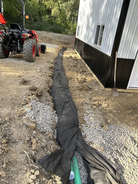

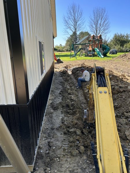

    Great work so far, and what a lot of work it is. Looks a lot like what I’ve got going on these days. Dug a 12” ditch around two sides of my new barn. Two pipes in the same ditch. One perforated for French drain the other solid for roof runoff. This is where I’m at currently.
    Went with sdr 35 instead of corrugated. There will be times I need to drive the tractor over it and just wanted to do it right and do it once(hopefully).
    My dad sitting down on the job. Guess he’s not getting paid today! Oh wait, he was never getting paid.
    All the pipe in and wrapped up. Have to leave one end open for now so I can tie in downspout, gutters supposed to be up soon. To the left of my tractor runs a swale down the back and around the other side of barn. Basically follows the same path of the pipes just up one level higher. The thinking is water coming down the hill will hit the swale first and the leftover will find its way to the French drain along with the ground water. The whole area behind barn is getting stoned all the way out to the swale. Have 17 yards of stone to move this weekend.
    I don’t have to tell you Eric Wanderweg just how much work a project like this is. Truthfully after the 2 long days it took me to get to this point I was burnt out on this project. Hopefully it pays off.
