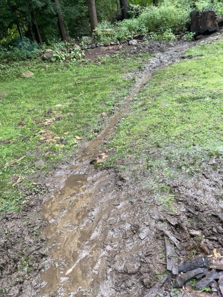

    Here’s what I’m dealing with in back end of my property. I dug this shallow trench as a test and it’s been flowing almost constantly for a couple weeks. Sometimes a trickle, other times a torrent. Unfortunately the direction I made these woodpiles isn’t helping. I’ll have to relocate them, consolidate my hoard better, and put in a couple swales. At least I know what I’ve got to do...

    Alright guys, you’ve twisted my arm enough today. I continued my Bandaid-fix trench around the woodpiles and towards the far corner of the property. For only being a couple inches deep it’s flowing really well. The water seems to be dissipating well into the ground over where the trench spills out. Later today we’re supposed to get some more serious rain so that’ll be a good test.

    Eric Schamell Does the water dissipate into a swamp or wooded area?

    Yes there’s about a half acre of woods adjacent to me that’s owned by the water company, and that’s where I’m directing all the water.
    My house is on a long hill so I get rainwater barreling through my backyard coming from way up above me. When it rains hard or for extended periods, it’ll flow steady for days. This year has been especially bad since we’ve had an extremely wet season. It doesn’t help that in certain parts of the yard I have heavy clay soil. The ground can only soak up so much.

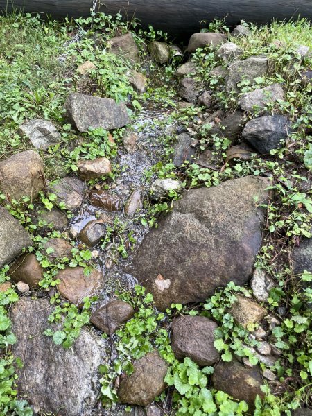

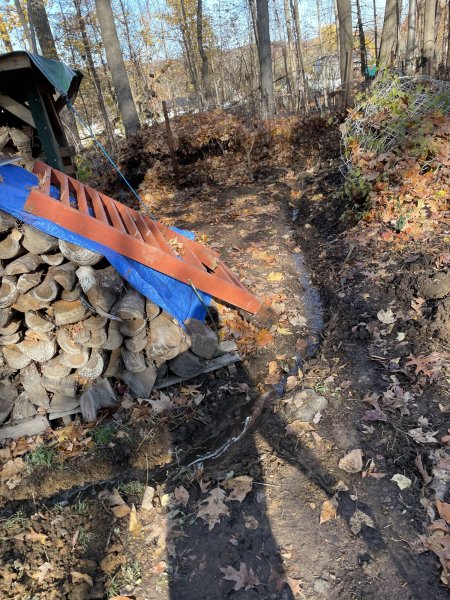

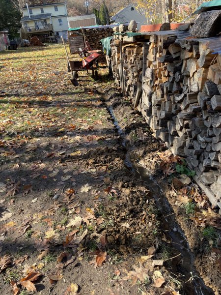

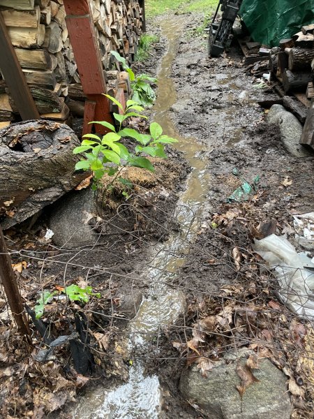

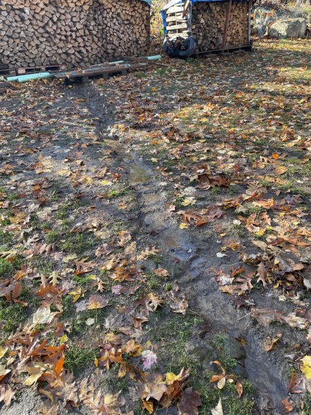

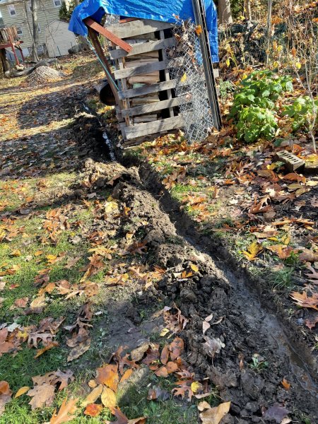

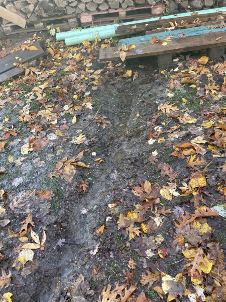

    2 years later and I’m still playing in the mud back here. I got all my stacks moved to one side of the yard and now I have a clear shot to divert the water into the woods. Today’s heavy rains got me motivated about this again. For now the shallow trench is helping, but eventually I’ll need to make it into a real swale that I can run the mower over. The French drain section with the riprap is still working as designed though.
