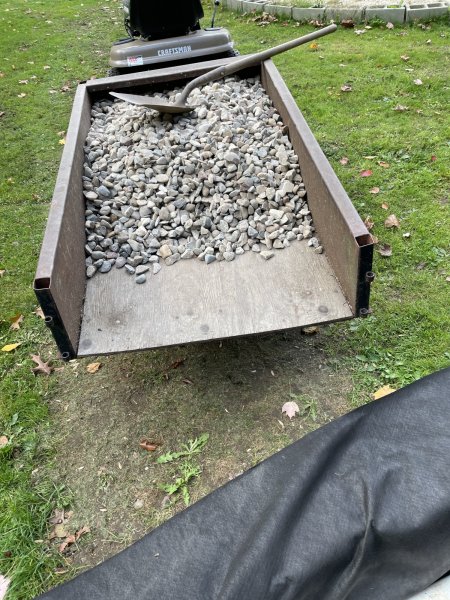

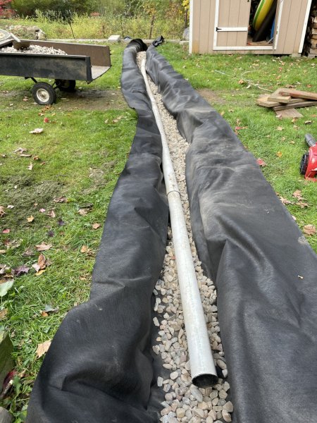

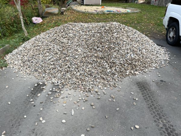

    The drain project’s been on hold for weeks as I’ve been busy with other stuff at home. Today I took a half day from work and got my stone delivered. More pictures to come as it continues...

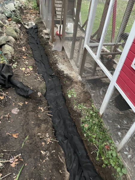

  4. Eric Wanderweg
    8,624
    68,449

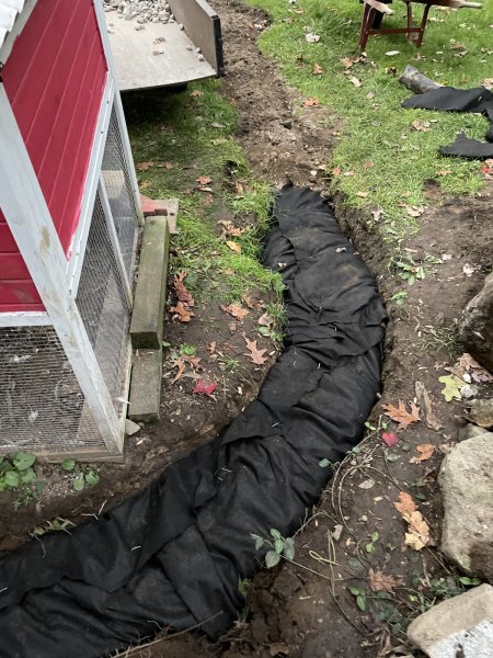

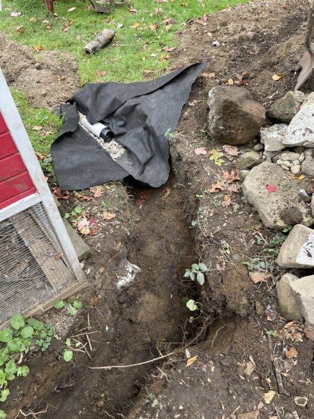

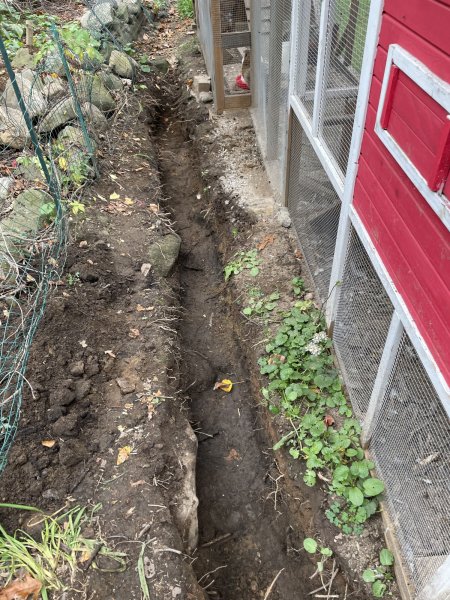

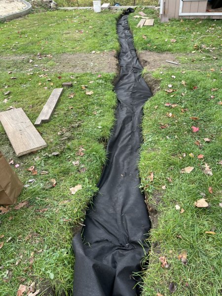

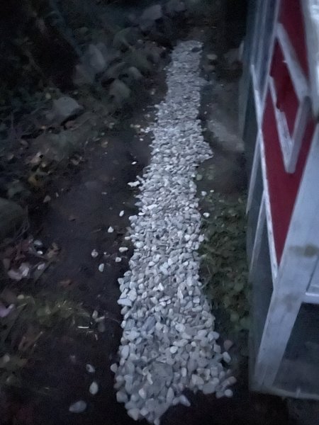

    The long easy section is filled with stone, burrito wrapped, stapled and ready for topsoil. Around the corner behind my chicken coop (where the trench starts) I need to remove a few nasty rocks and dig it a little deeper and wider. Not bad progress for today though.

    Eric Schamell , looks great, Eric. Are you going to plant grass on top or just put more gravel up to ground level?
  6. Eric Wanderweg
    8,624
    68,449
    I’ll be planting grass on this section anyway, so as to hide everything. On the section behind the coop, which is shaded and along the edge of my property, I’m going to do an open French drain. Meaning, after its burrito wrapped, I’ll top it off with more stone. I’m also adding a clean out up there, in case I ever need to jet out the system with water.

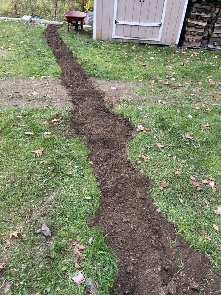

    This is enough for today, I’m whooped. Not a bad start on things, not having touched it for over a month.

    This is as done as it’s going to get on a Sunday night. I also worked my full time job both days this weekend, suffice to say I’m feeling a little beat :wacky:
    Big rains are supposedly coming this week so it had to get wrapped up today. I still have to do the final leveling of the dirt, add grass seed, and build a little rip rap section at the outlet where it dumps out, but I’m happy with what I got done between Friday and Sunday night.

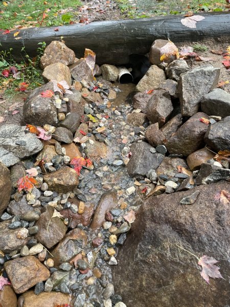

  11. Eric Wanderweg
    8,624
    68,449

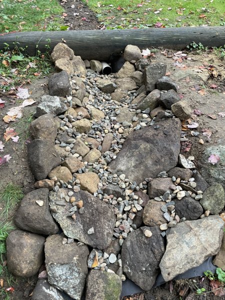

    Riprap is in. I might put some more time into it down the road, adding shrubs and whatnot. At least it’s functional right now.

  13. Eric Wanderweg
    8,624
    68,449
    This is probably the first time in my life where they’re predicting 3-4 inches of rain and I’m actually hoping it happens :)

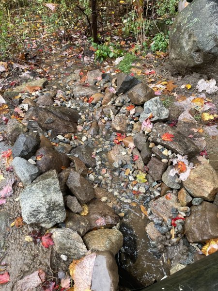

    It’s working... I do however have puddles forming in other parts of the yard. I guess that’s to be expected with this volume of water. I’ll definitely need a couple more drains.
