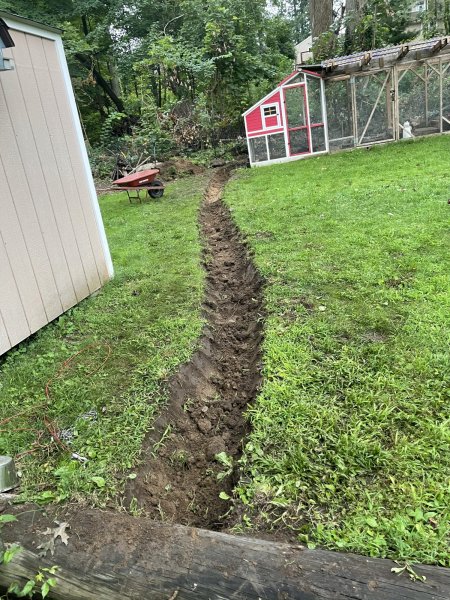

    Well, considering I might be getting 6 inches of rain this weekend, I guess all the manual labor will be worth it. I figure I’m 2/3 of the way there on the depth of it. This will be one of 3 trenches I dig. 0A865B10-93AD-4713-AA74-B63ABD665CA8.jpeg

    Do it when it's pouring out, seriously. Once it's flowing the solvent action of the water helps a lot. Scrape away with a mattock a bit at a time.
