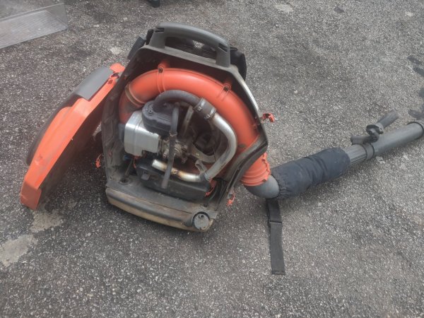

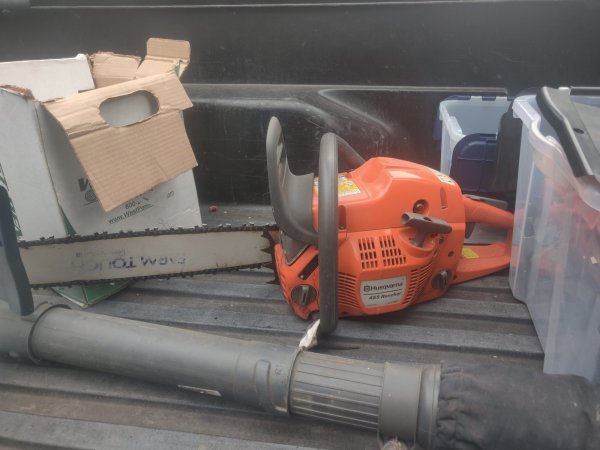

    Aw yeah. Both of them run. Added some TruFuel to them and away we go.
    Woooo hoooo!
    Perfect timing. Was just thinking about leaf blowers!
    And it's a 20" bar not 18". 3/8" pitch, .050" gauge. Perfect as it uses the same chain as my 034 Super. 33RS72.

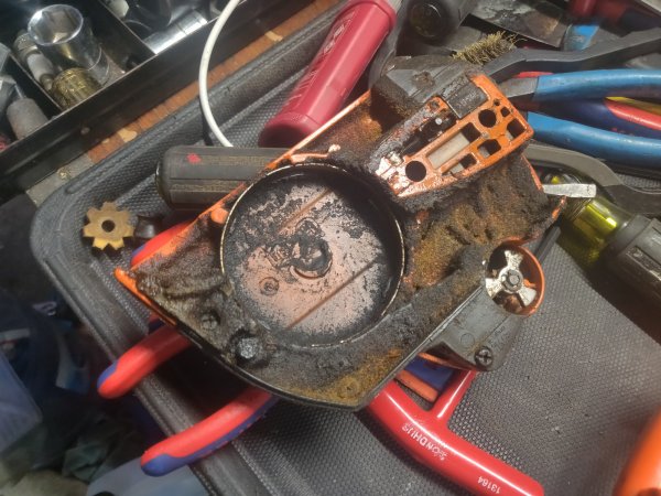

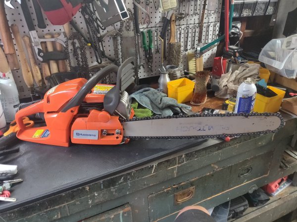

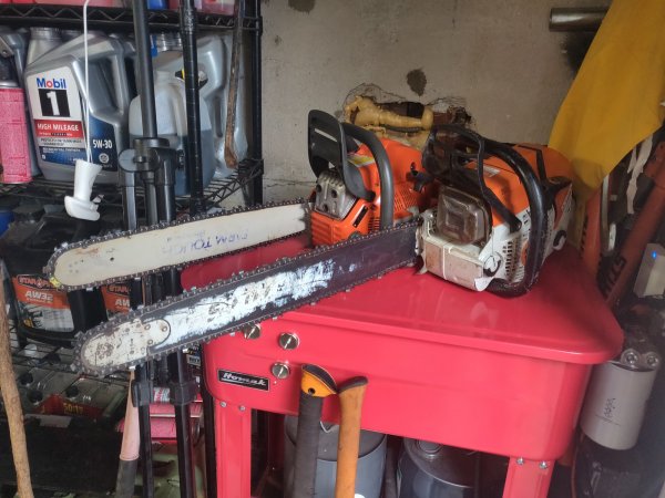

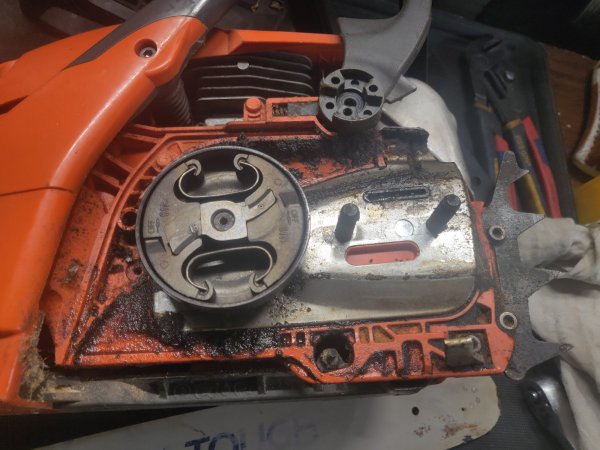

    I cleaned up the 455 yesterday. I don't think it was ever cleaned. Put the chain aside and slapped a new Stihl RS chain on there. Used the parts washer and gave it a quick bath. Greased the needle bearing. Spur sprocket looks fine. This thing was used but not much it seems. And here it is hanging with a 500i!

    That saw is extra ugly next to a 500i :rofl: :lol:
