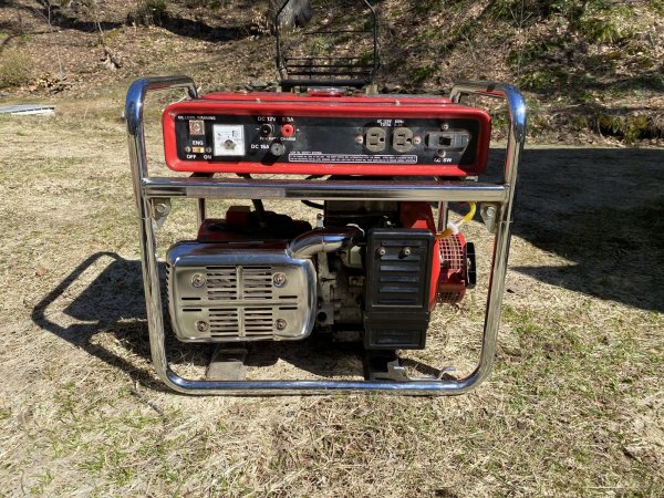

    Update on the Toro. We brought the unit back to the flatlands for the winter so I could tinker with it. It was surging and I found out it was getting too much fuel. I spent quite a bit of time trying to bend the tab on the float to hopefully cure the issue. No dice. With the bowl off the carb, I was either getting fuel dripping with the float level or no fuel at all; I could not find the sweet spot.
    Slept on it and pulled the needle valve assembly, blasted things out with carb cleaner and that solved that. Picked up a fuel filter and used some smaller ID fuel line (vs the 1/4” I was using). Got it fired up and it still surged, unless I had the choke on. Thought I was running lean. But it eventually settled out and ran great. So fingers crossed.
    I then went to shut the unit off, and the on/off switch decided to stop working. LOL! More tinkering ahead…

    Here’s a pic of the Toro. This thing cleaned up amazingly well with a little Quick Detailer and some 0000 steel wool. The chrome really pops! Again, they don’t make them like they used to.
    I’m having a bit of an issue with the on/off switch. It started fine today, but I really had to push the switch to turn it off. A few weeks back, it would not start. I pulled the panel off, took the wires off the on/off switch, reattached, got spark and she fired up. So something is a little wonky with the switch or the connections to said switch.
