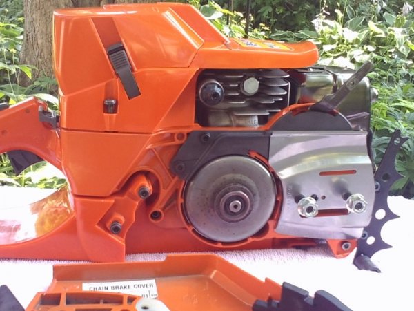

    Here are the latest pictures of progress

    Looking great :thumbs:

    That looks great...Your doing a great job KRL :yes:
