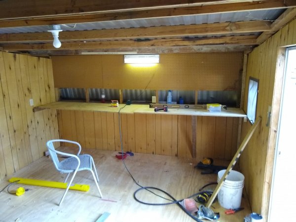

    I would buy the new shop light at Walmart. It was only like $17. But I'm putting these In my new to me shed. Ceiling is very low and I was screwing these on the side of the ceiling joists. They only hung down .5-1" below the bottom of the 2x4. So I would have to get creative to fit the double tube light so that I wouldn't walk into it. I already have to kind of tilt my head as it's low.
    See the picture. I was screwing on the joist one away from the peek of the roof. On the side that was facing the bench for light. I have an extra set of strip LED lights that will go right over the bench so that part is covered..I think.
    I also have an old double tube fixture I could use. I may see how deep the new ones are and see if I mount a 2x4 sideways between the rafters and then punt the light to them, up between rafters running parallel to the rafters. IMG_20190817_182527110.jpg

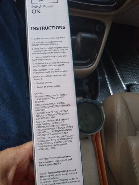

    As far as instructions, there are some instructions on how to replace a tube, but not on wireing. I am attaching a picture of that.
    If you can't read it cause it's blurry. It basically says cut power off, remove diffuser, twist tube out to remove it, place new one in line lines up with slots , twist in........ IMG_20190827_072912170.jpg
    So maybe since no mention of if replacing florescent tubes cut out the ballast you leave it? Or are they just to replace LED tubes in the fixtures they sell and others that started life as LED? But if the latter is true they should be like others I have done, power on one side neutral on other.

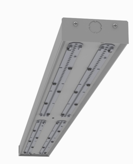

    Here is a pick of a Lumax light.
    brenndatomu, Horkn and clemsonfor like this.
