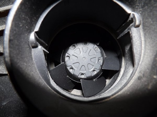

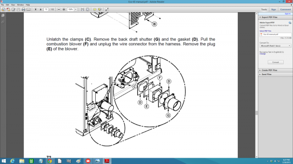

  10. wildwest
    30,722
    145,089
    I found it in the manual! It is letter G, actually the small computer fan as RockyMtnHigh called it earlier. No flapper on this model.... The fan was turning when I unhooked the OAK and again after reassembly.
