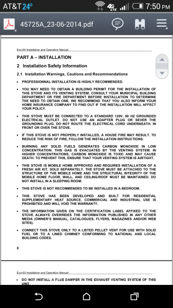

    4" OAK is pretty hefty. Does that stove have an inlet that big?

    The later version does....the one Wildwest has is only 3"

    That's what your picture looked like. The pellets don't seem to be fully burning up...Maybe just nee the LBT done to it....

    I have the same page 8 as you

    subsailor
    "It is mandatory to connect this stove to an outside combustion air source to reduce the risk of hopper burn back caused by negative pressure. A insulated 4” inside diameter metallic pipe, either flexible or rigid, must be attached to the inlet at the stove’s rear (refer to figures 5, 6 & 7)."

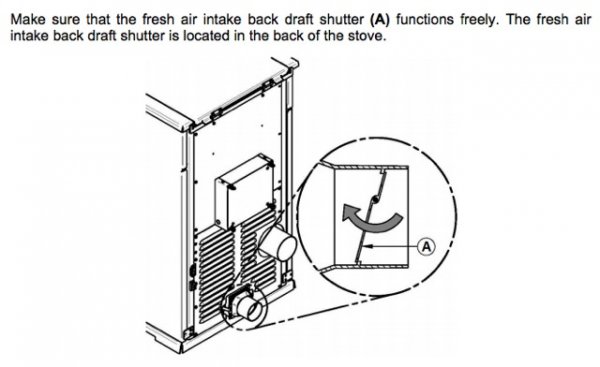

    Almost an hour later I pulled the panel to look for the damper/flapper. I shut it off over an hour ago and hubby said it was still on and turned it off again after he got home. While looking for the damper in "off mode" I realized from the INSIDE the auger was still turning.
    Houston, we have a problem.
    I unplugged it.....

    The flapper/damper is located inside the fresh air inlet on the stove......you'd have to remove the OAK pipe to see it. You need to make sure it's moving freely, and not stuck closed or partly closed.

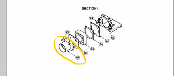

    97 30777 PLASTIC BACKDRAFT DAMPER ASSEMBLY
    I wonder if it has anything to do with that little guy.... Page 84 drolet.png
