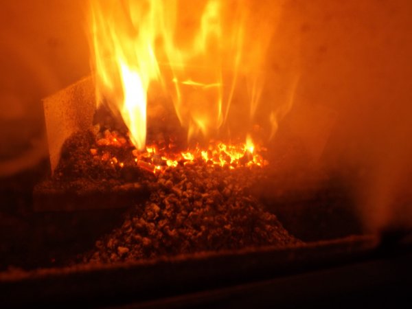

Flames in Ash Pan?
Discussion in 'Pellet Stoves, Pellet Fireplaces, Pellet Furnaces' started by wildwest, Nov 25, 2014.
  1. wildwest
    30,722
    145,089
    I thought it was getting too warm in here :rofl: :lol:
    ivanhoe and IHATEPROPANE like this.
  2. SmokeyTheBear
    SmokeyTheBear
    8,343
    39,489
    Standish, ME
    No burning in the ash pan it is not a good thing fire is supposed to be elsewhere. How did unburned pellets get there? That is also a no no.
    ivanhoe, IHATEPROPANE and wildwest like this.
  3. wildwest
    30,722
    145,089
    Second time it's happened SmokeyTheBear . First time Drolet told me not to run MY particular serial number above level 4 (levels 1-6). By the looks of the avalanch of pellets that now spilled into and filled the ashpan the auger was feeding too fast. Will call them again tomorrow during business hours. Apparently my stove was a first run on "upgraded" model.

    Agreed. The auger timing may be the problem, or at least part of it. It sounds to me like the stove design just can't flow enough air through the pot for a complete burn on higher heat settings.....why else would they say to not run it above 4?

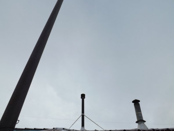

    I just ran through some steps suggested for me the first time. OAK it totally free and clear. Pipe and cap are upright (ahahaha, finally something got me out of the house:rofl: :lol:) Cap is black color but but does not appear to be clogged (3 wide veins) that are visibly open from the ground. No screen.

    Any chance of some pics of the firebox? Black soot on cap may indicate a rich air/fuel mixture, which would somewhat confirm what I said above about not enough air through the burnpot. Anytime I looked up into my exhaust pipe on the Astoria or 10-cpm I had, the pipe is coated with light/medium gray ash.

    One way or another there is not enough air. Could be many things. Flakey board, improper install, dirty stove, poor engineering, bad pellets, elevation challenges amongst others. Was the venting ever described in detail?

    Did the best I could. Left is flag pole, right is abandoned smoke dragon pipe, middle is the pellet stove. PS, I bought black pipe... DSCF1479.JPG

    Thanks for the pics. Better firebox pic would be after it was shutdown, and taken so as much of back firebox walls can be seen clearly. Understandable if you don't want to shut it down due to the cold conditions.
