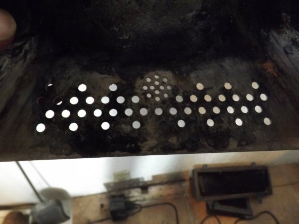

    Observations:
    After this last ashpan fire the ash/soot I cleaned was much darker or blacker than previous cleanings.
    Cleaning the holes in the burn pot, doubt it helped as this is the pic before hand:
    He ran like sized drill bits through the holes by hand (no drill) anyway as suggested by Drolet. PS the holes that look blocked in the upper left is my fingers holding the burn pot up for the pic :)
    IHATEPROPANE, ivanhoe and slvrblkk like this.

    Tell him that brass gun bore brushes work very well keeping burn pot holes clean and won't damage the burn pot at all. You just have to get the correct size brushes.
    IHATEPROPANE, ivanhoe and wildwest like this.

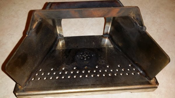

    This stove has two blowers for combustion (confusing to some. But it works well). The combustion blower (before the pot/by the OAK inlet) is for when the stove is calling for heat and needs more air. When the stove is in maintenance burn (stat is satisfied) only the exhaust blower runs.
    Also, it should have some trim settings. Even though it does not have the touch screen interface like my stove, it should have some type of adjustment? Why would a higher BTU stove with the same blower motors have no adjustments? ?
    If they have changed the OAK inlet to 4"? What did they do? The outer inlet is only held by 2 latches? Seems that it should just be a new inlet they can send you?
    As for a dirty stove after 60 bags? I know many people go much father than that with a 3" vent system. I just cleaned mine today after over 2 ton and it was not bad at all. I could easily go a full year (or 2).
    I have tomorrow off and will read the manual and dig into this further.
    I have bought a 2nd burn pot from Don2222 and have begun to experiment with other holes further back by the ignitor. I have not done this because pellets overflow, but because of carbon build up. No air back there creates a large build up of carbon. But in WW case? Maybe the extra burn air earlier in the pot will help with the pellet burn?
    This is my stock pot. My experimental pot is in the stove now.
