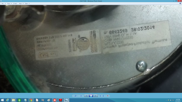

    SmokeyTheBear , I am under the ignitor and still no flap. Matter of fact I can feel cold air from the OAK. What do you think?
    IHATEPROPANE likes this.
  18. SmokeyTheBear
    SmokeyTheBear
    8,342
    39,485
    Standish, ME
    Manual is out to lunch or there is something missing for whatever reason. Them's the choices, now how about a picture of the exhaust blower, if there are number we want them.
    There are all kinds of blowers and they have differing CFM ratings.
    I might spend some time reading through the manuals to find things that might be hinted at.
    IHATEPROPANE, ivanhoe and wildwest like this.
