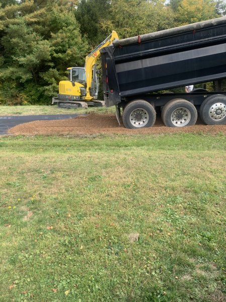

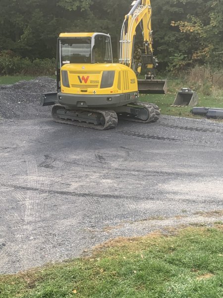

    Well since we had a tornado up here, 2006 ish! I have been complaining about my drive.
    That year we ran many pieces equipment and 18 wheelers up and down my quarter-mile driveway. Including 80,000# Feller Buncher on the tractor trailer and ran numerous 18 wheelers loads of wood chips out.
    This had the effect of pushing driveway down 6 inches or so below the swails creating a seagull or kids slide effect.
    We had a good year so I decided to fix it.

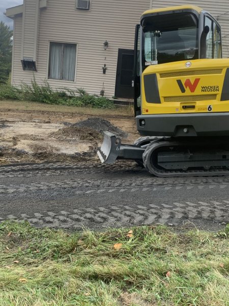

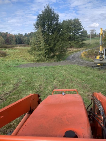

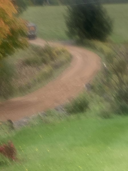

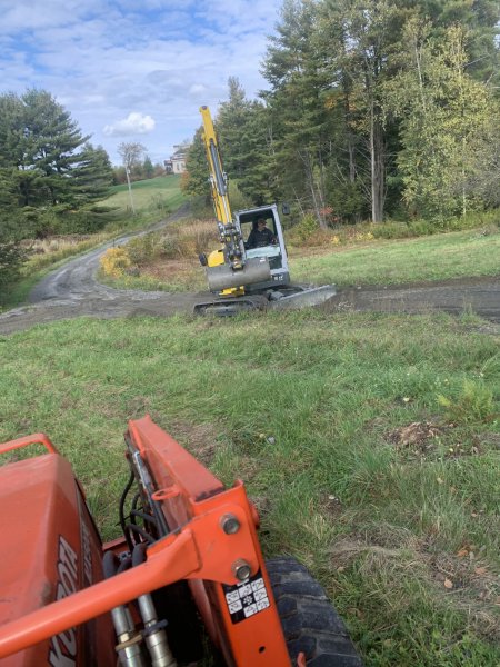

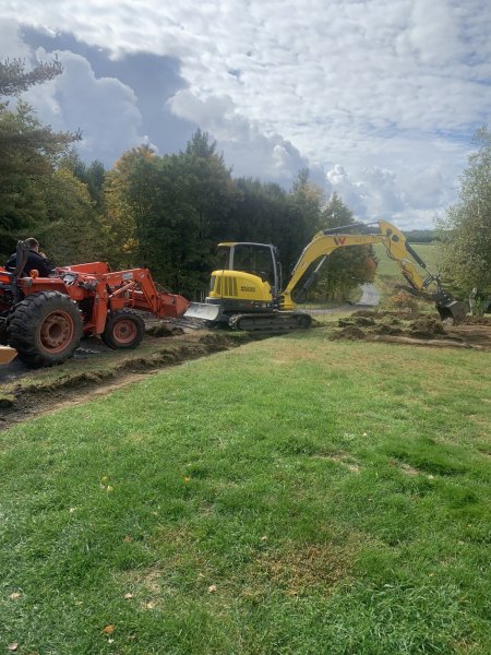

    Step 1 excavate bad area add extra parking C094FE48-4BC3-4043-9ECE-73291125D5A7.jpeg

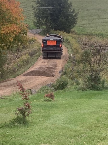

    more pics I ran out of time 7501DE72-C020-42ED-B42C-A996467F0C7E.jpeg A6972F32-C513-43D0-AB3D-8178165DB518.jpeg 1A5FFD2E-02F2-4632-B94A-2444B48A4174.jpeg A6F78659-9E20-470D-A6C7-091F505724D6.jpeg C3229564-FFAF-4259-A5AA-533164DDDB81.jpeg

    Chip and Seal or rock?
  5. Canadian border VT
    17,773
    115,883
    Rock here is labeled as 70603a Basically 3/8 minus 300 yards or 17 18 yard trucks and not finished :bug:

    Well Well Seasoned and Horkn have been down my driveway and they will tell you it’s nice but every time it’s rained it’s an 2 hours on box blade on Kubota

    Those rolls on right are 3 rolls of heavy duty road fabric that will prevent pot holes and sinking. I asked our resident JCMC road guy he said go HD as it’s :emptywallet: versus what’s on top:makeitrain"
