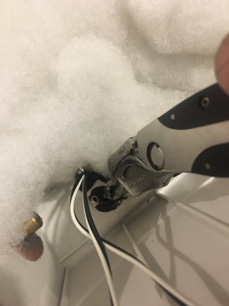

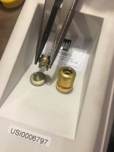

    Just had a mishap and the almost new speaker fell the wrong way. The Banana jack on the back of the Dual LU53PW speaker broke!
    So final cost was $12 for the banana jack plate but if you wanted a lower budget and easier fix, just drill a hole under the banana jacks on the speaker and bypass the jacks and just run a wire thru the hole and tape it to the ones inside.
    Has anyone else done this??

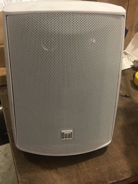

    Pic 1 - Indoor outdoor speaker

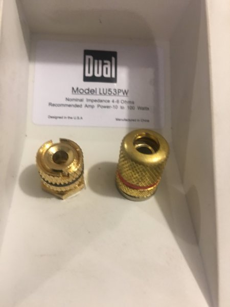

    Pic 2 - broken black negative banana jack connector.

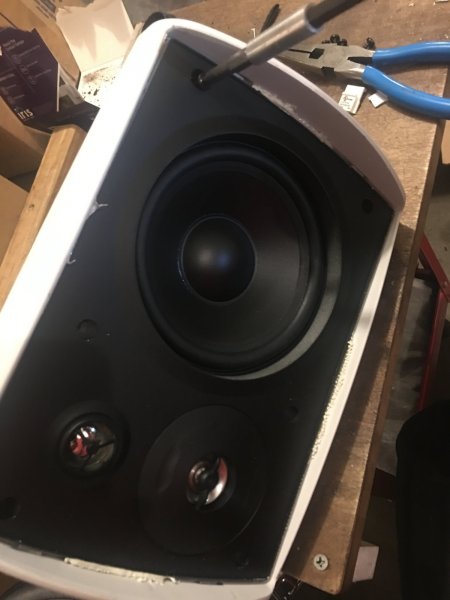

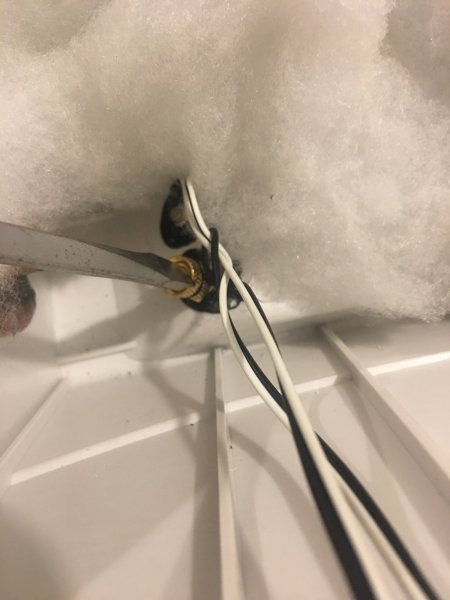

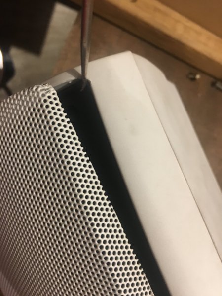

    Pic 3 - Gently pry off grill starting in upper right corner using a pick probe

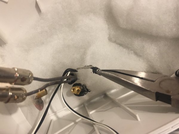

    Pic 4 - Remove 6 Phillip head screws and remove from speaker mounting panel with speakers atteched

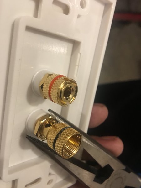

    Pic 5 - Remove nut that holds old banana jack

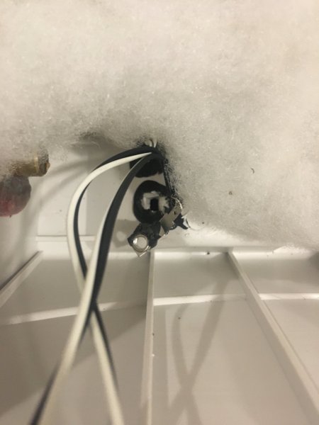

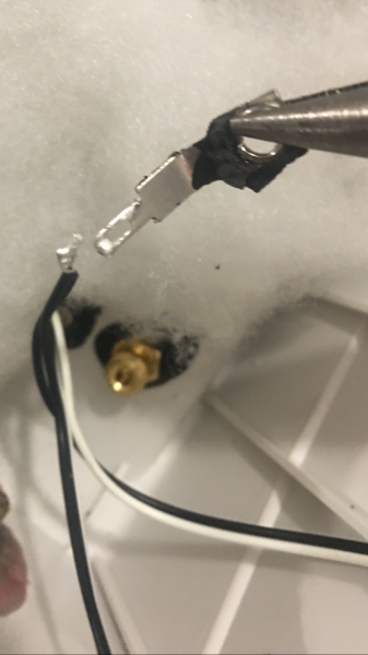

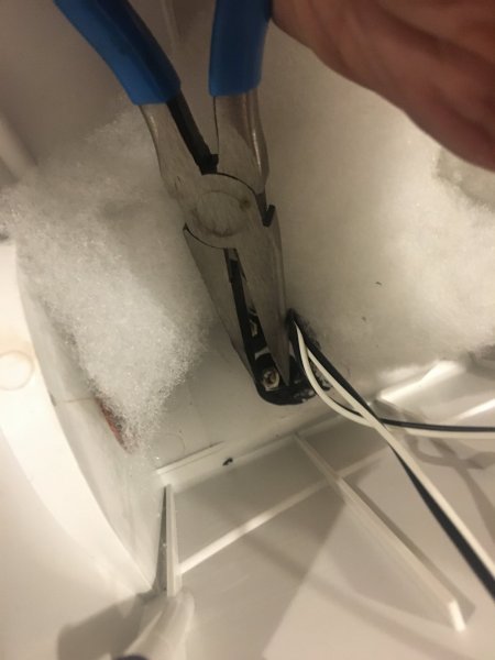

    Pic 6 - cut black potting compound to remove connector wire and lug
    Pic 7-8 Remove lug and desolder wire from it.

    Pic 10 - new banana jack from Home Depot
    Pic 11 - remove correct color bananka jack (black in this case.

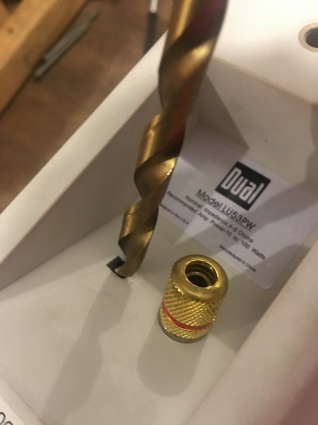

    Pic 12 - drill 3/8 hole in speaker cabinet to accept new Banana jack - Start with smaller bits and work up to prevent gouging

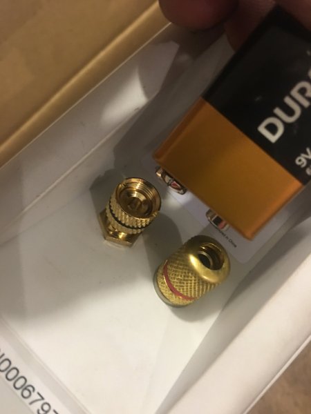

    Pic 13 - insert new banana jack and tighten with holding but then insert wire in hole and put cap on and tighten cap with screw drive
    Pic 14 - test with 9 volt battery

    I really like this 9 volt speaker test trick!

    Fun with electro-magnets.
