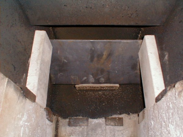

    The reduction on a 15 foot test chimney by Fisher Research and Development was from 60 grams of particulate for every kg. burned down to 6 grams for every kg. burned.
    The theory was to roll smoke down into the flame and increase firebox temperature. Larger particles are prevented from escaping directly up the stack since particle size was the issue as stricter regulations went into effect in stages. By the third stage something was going to have to change to produce any stove and catalytic converters were in use on autos that were then designed for wood burners. Later, secondary combustion became what we have today.
    Only the double door stoves were fitted with baffles and I got the idea of putting one in a Mama Bear that was being tested in my kitchen for other reasons. Milk in the fridge door went sour overnight so I set up temporary shielding between the back of the stove and fridge about 6 feet away. That took care of the milk issue but the cement board wasn't going to stay propped up in the middle of the kitchen long. This was our only heat source that served as back up cooking and clothes drying all winter. So sitting at my PC looking at the side of the stove, I drew on the stove with chalk where I thought the baffle should go to divert the extreme heat forward INSIDE the stove instead of out. I had extra brick here so I set the bricks on their sides and sat a plate on them without the shield that night. I realized as soon as I lit it that the smoke was greatly reduced and realized how close to the "Smoke Shelf Baffle" in the later double doors mine was. I ended up making a few for friends and neighbors and realized with different chimneys I could fine tune them for the heat needed up the flue. It wasn't until the stove triathlon a few years ago that I realized if everyone would simply baffle their old stoves it would clean up the air a lot without the cost of a new stove. Instead of starting my own website for Fisher Stoves, I posted the well know baffle thread on Hearth that has over 77,000 views! All I was trying to do was prevent my milk from spoiling! It was a Brown Mama Bear too. The only original brown stove in my collection. Since then I tested the baffle in all the single door models on the same chimney.
    Brown Mama Bear in kitchen 2011 2.JPG With baffle this was the only heat source in my 1850 square foot home all winter!
    Brown Mama in kitchen 2011.JPG The view from my PC contemplating how to direct the heat forward away from fridge.... With single cement board under tile the floor protection is just below minimum so I added the heat shield under it and the floor stayed cool. There is felt glued to bricks to prevent scratching floor since this is where all the stoves were later tested. One night of testing the Baby Bear and back to the larger stoves we went.
    Brown Mama Bear Baffle 4.JPG I learned real quick to wedge a piece of firewood across the stove to hold the side bricks in place while I sat the baffle plate on top of them, then slide it rearward until it drops in place in the back. I took the measurements for some and made the plates to find their stoves were going when I got there. Crash the fire down and with welding gloves installed them over coals. It's that easy to put them in place once you've done it.

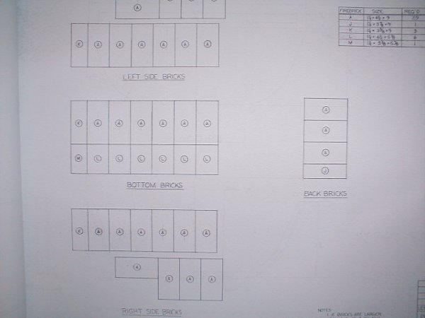

    In 1977 there was a drawing revision sent to fabricators that could add a second course of brick to raise combustion chamber temperature. It wasn't to protect the side sheets. Not all fabricators added them and it wasn't mandatory. You can remove them.
    Here's a pic of the original print showing the new brick layout for Papa. I can't copy the full page, they are 2 X 3 feet in size;

    Coaly, THANK YOU. I did not know it was safe to remove that second row of top bricks, I am sure that will make this much more straight forward to install a baffle. I appreciate the excellent information from you.
